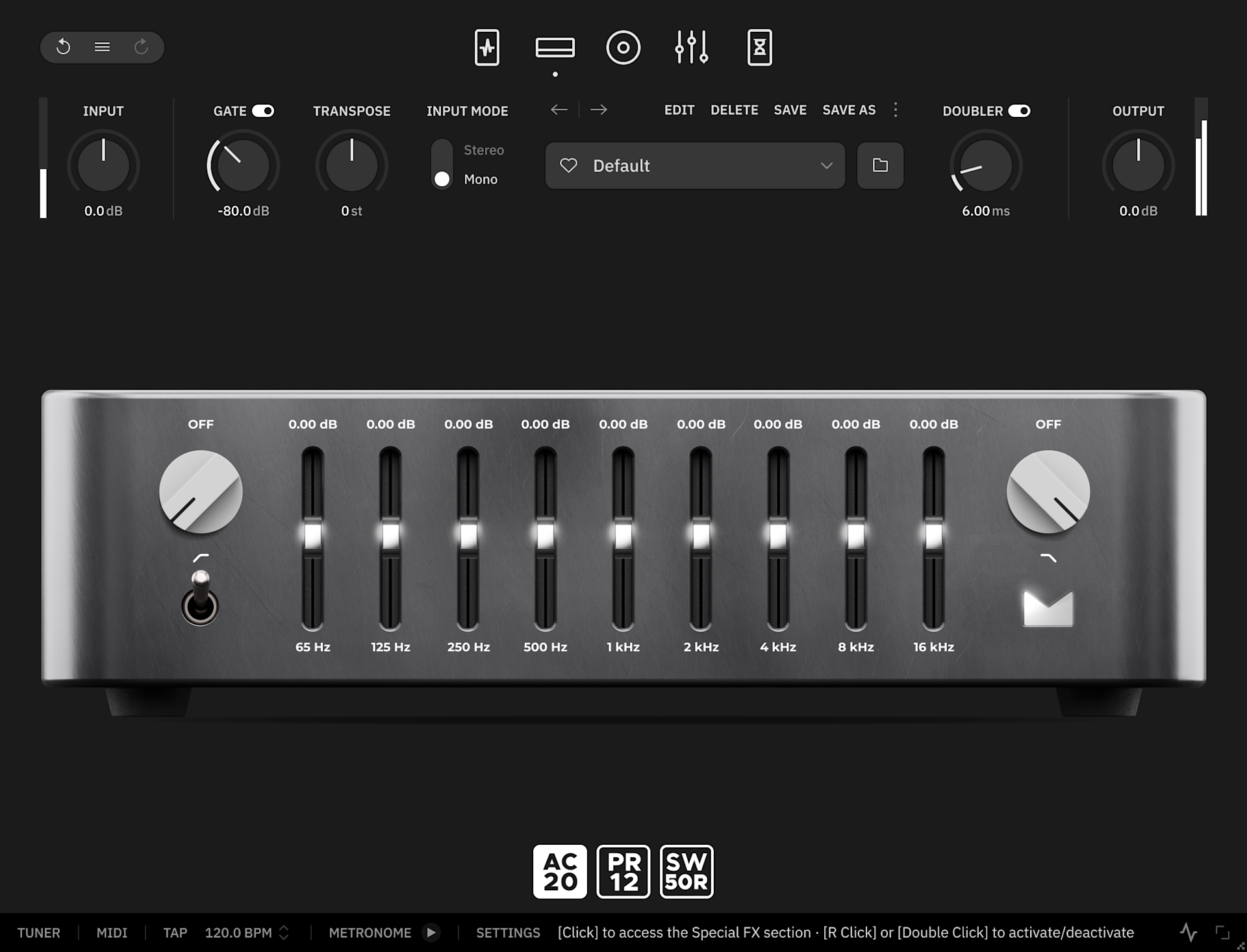

In the world of guitar amplification, few names shine as brightly as Morgan Amplification. For over a decade, this illustrious company has sculpted soundscapes and shaped musical journeys, earning a place of honor in the pantheon of amplifier legends.
Founded by the visionary amplifier builder and guitarist Joe Morgan in 2009, Morgan Amplification emerged as a beacon of craftsmanship and innovation in the industry. Drawing inspiration from era-defining vintage tones, Joe set out to create amplifiers that not only paid homage to the classics but also pushed the boundaries of sonic possibilities. The result? A legacy of amplifiers revered for their meticulous attention to detail, exceptional build quality, and incredible tonal artistry.
Joe Morgan started building his amplifiers during the boom of boutique pedal builders and his motto was to provide amplifiers designed for the working musician and their need for amps that work with complex pedal boards. These amplifiers have become the trusted companions of artists seeking an unparalleled blend of warmth, responsiveness, and harmonic richness.
We've painstakingly replicated the essence of three of these iconic amplifiers, ensuring that every note you play carries the rich heritage and the boundless potential of Morgan Amplification.
We proudly present to you, the Morgan Amps Suite X.

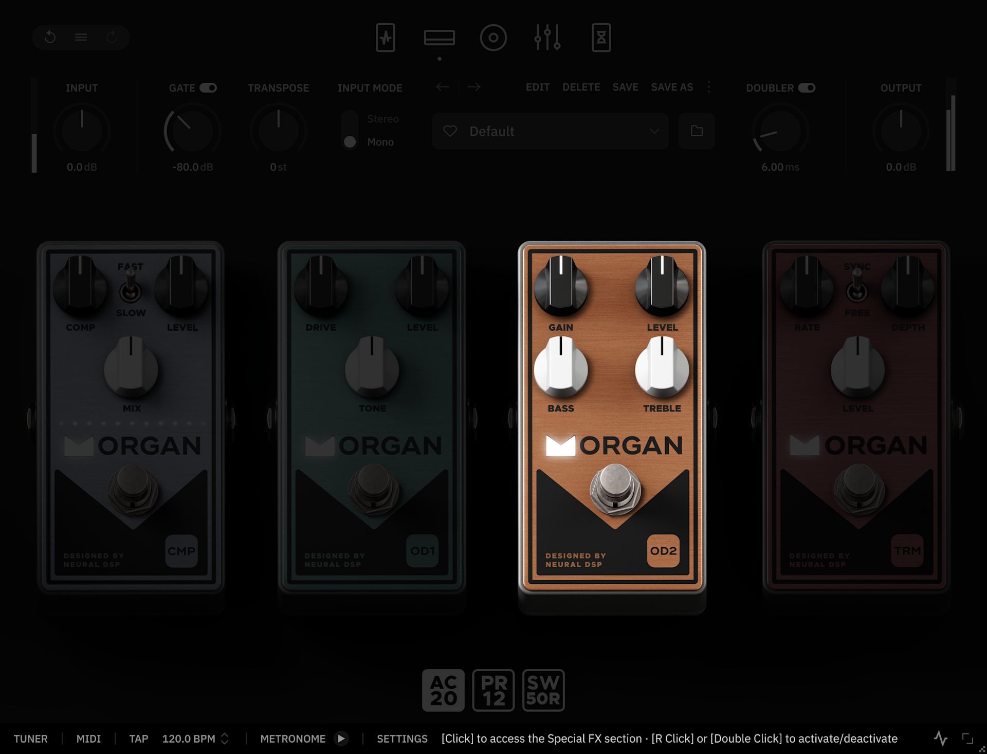

Pre FX Section
This section consists of three effects in series which can be used either separately or combined.
“CMP” - Compressor Pedal
  1. Comp Knob: Controls the amount of compression applied by the pedal.
  2. Release Mode Switch: Toggles the compressor time constants, switching the attack and release speed behavior.
  3. Level Knob: Sets the output level of the pedal.
  4. Mix Knob: Controls the amount of compressed signal that is mixed with the original dry input signal.
  5. Gain Reduction Meter: Indicates the amount of gain reduction.
  6. Engage Stomp Switch: Click to activate/deactivate the CMP pedal.
“OD1” - Overdrive Pedal
  1. Drive Knob: Sets the signal level feeding the overdrive, controlling distortion.
  2. Level Knob: Sets the output level of the pedal.
  3. Tone Knob: Adjusts the high-frequency response of the pedal.
  4. Engage Stomp Switch: Click to activate/deactivate the OD1 pedal.
“OD2” - Overdrive Pedal
  1. Gain Knob: Sets the signal level feeding the overdrive, controlling distortion.
  3. Treble Knob: Adjusts the high-frequency response of the pedal.
  4. Bass Knob: Adjusts the low-frequency response of the pedal.
  5. Engage Stomp Switch: Click to activate/deactivate the OD2 pedal.
“TRM” - Tremolo Pedal
  1. Rate Knob: Controls the speed of the tremolo effect. The higher the value, the faster the speed.
  2. Sync Switch: Toggles between sync (Note) and free (Hz) behavior.
  3. Depth Knob: Sets the amount of tremolo effect applied to the signal.
  4. Level Knob: Sets the output level of the pedal.
  5. Engage Stomp Switch: Click to activate/deactivate the TRM pedal.

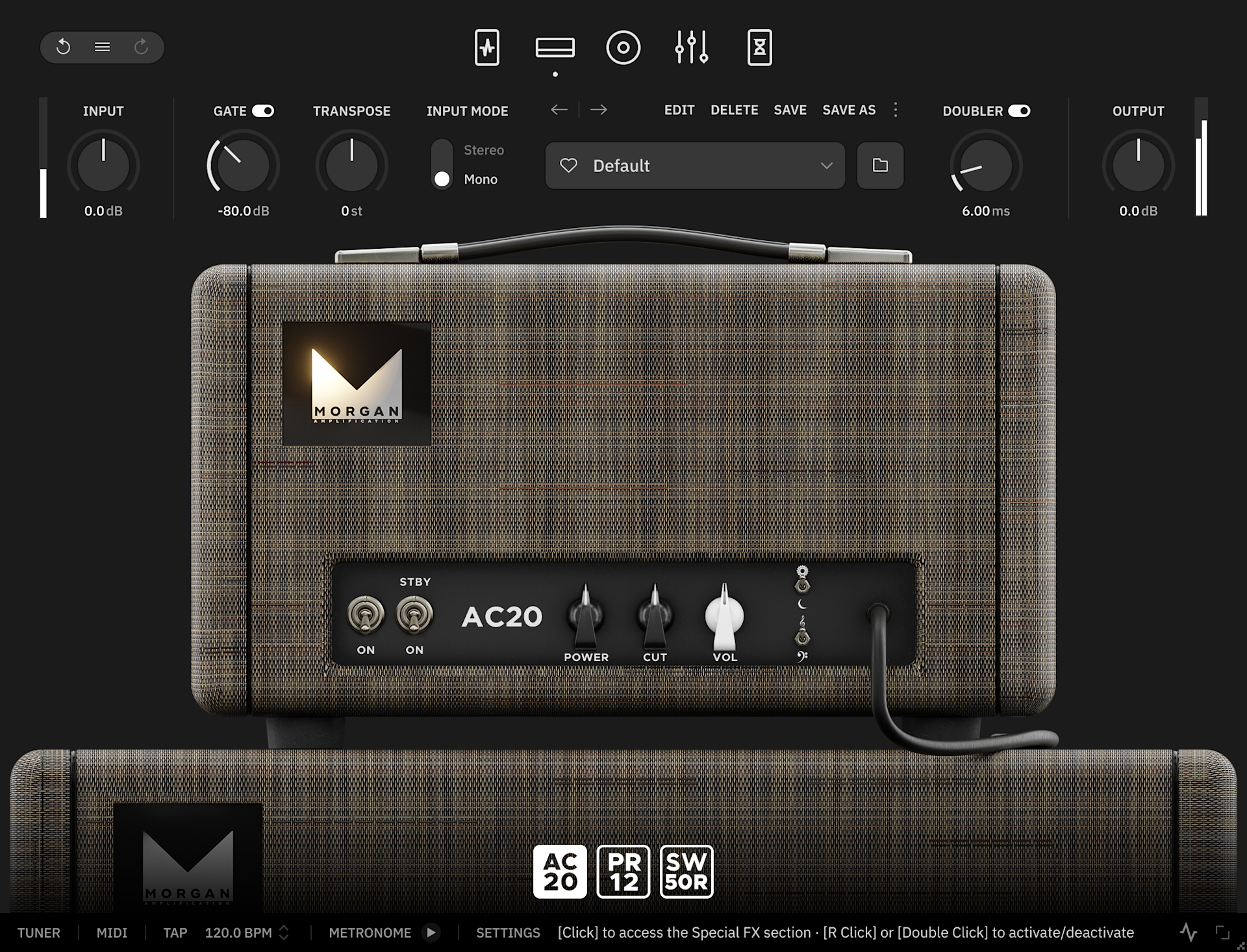

Amp Section
AC20 Amplifier
  1. Power Knob: Reduces output volume by lowering the power amplifier wattage.
  2. Cut Knob: Rolls off high frequencies in the power section. Turn down for a darker tone.
  3. Volume: Adjusts the preamp gain level, determining the amount of distortion.
  4. Bright Switch (Sun/Moon): Emphasizes the upper frequencies to make the tone brighter.
  5. Bass Cut Switch (G/F Clefs): Reduces low-end in the preamp for a tighter, cleaner tone.
  6. Standby and Power Switches: Click to activate/deactivate the Amp Section.

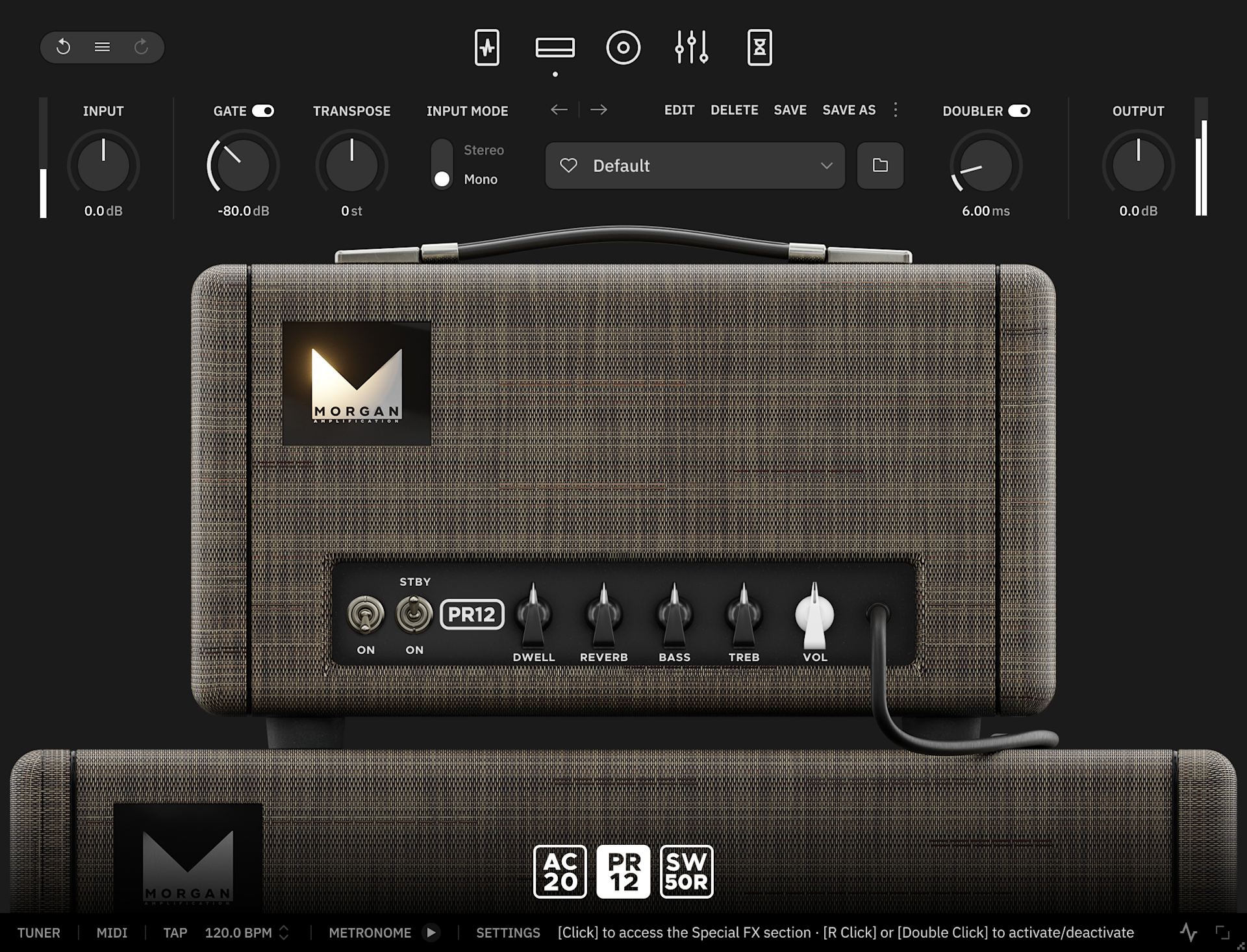

PR12 Amplifier
  1. Dwell Knob: Adjusts the intensity of the reverb’s reflections.
  2. Reverb Knob: Controls the amount of reverberated signal that is added to the dry signal.
  3. Bass Knob: Adjusts the low-frequency response of the amp.
  4. Treble Knob: Adjusts the high-frequency response of the amp.
  5. Volume Knob: Adjusts the preamp gain level, determining the amount of distortion.

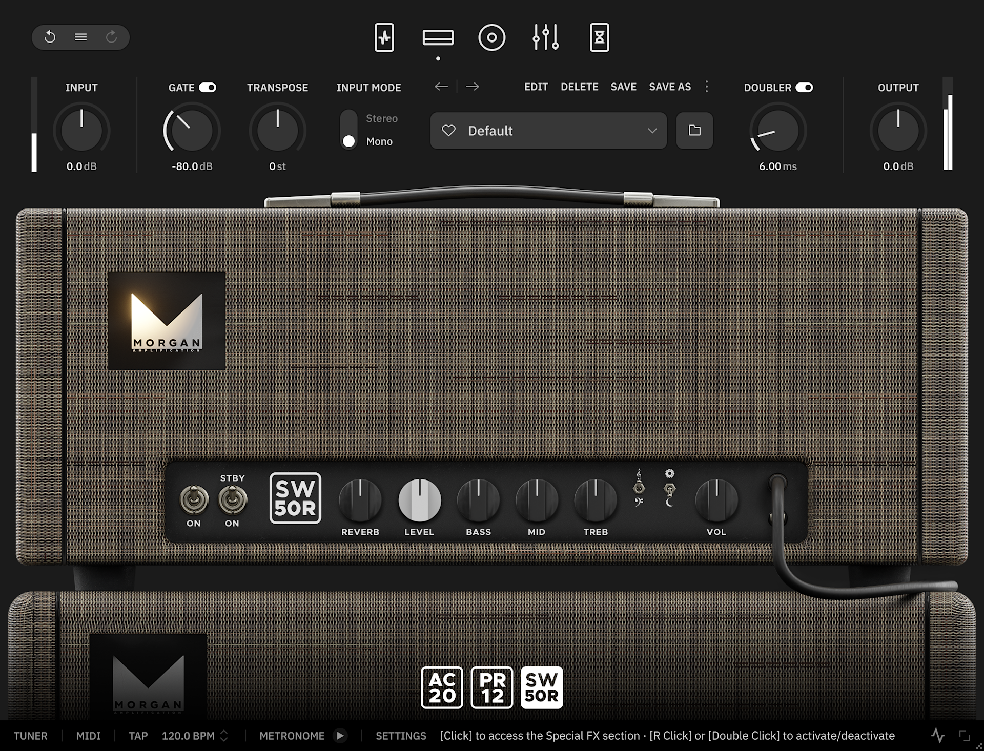

SW50R Amplifier
  1. Reverb Knob: Controls the amount of reverberated signal that is added to the dry signal.
  2. Level Knob: Sets the amp’s master level. Higher settings add power amp saturation and sag.
  4. Mid Knob: Adjusts the mid-frequency response of the amp.
  5. Treble Knob: Adjusts the high-frequency response of the amp.
  6. Bass Emphasis Switch (G/F Clefs): Enables the low-mid frequencies boost.
  7. Bright Switch (Sun/Moon): Emphasizes the upper frequencies to make the tone brighter.
  8. Volume: Adjusts the preamp gain level, determining the amount of distortion.
  9. Standby and Power Switches: Click to activate/deactivate the Amp Section.
  10. Amplifier Input: The bottom position attenuates the signal by 6dB.
Hint:
Click the Amps’ logos to cycle through different amp skins.

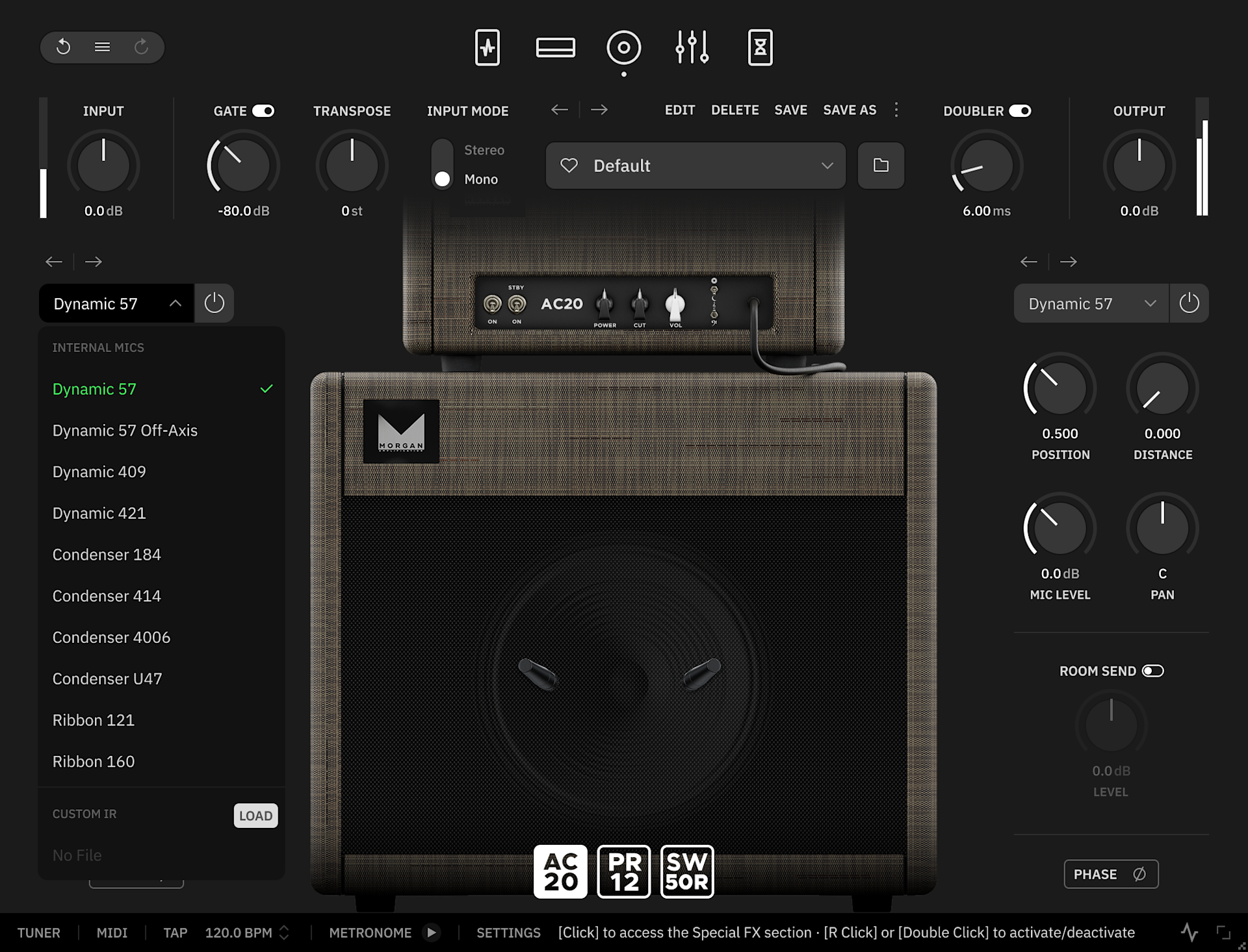

Cab Section
A comprehensive cabinet simulation module that features virtual mics that can be positioned around the speakers. Additionally, in this section, you can load your own Impulse Response files.
What is an Impulse Response?
An Impulse Response is the measurement of a dynamic system reacting to an input signal. This information can be stored in WAV files that can be used to recreate the sound of spaces, reverberations, and instrument speakers.
Cab Section Controls
  1. Microphone Selector Drop Down Menu: Click to select between the factory microphones or loading your own IR files.
  2. Navigation Arrows: Click to cycle through factory microphones and custom IRs.
  3. Bypass Button: Click to bypass/enable the selected microphone or custom IR.
  4. Position and Distance Knobs: Control the position and distance of the factory microphones around the speaker cone.
  5. Mic Level Knob: Controls the volume level of the selected mic/IR.
  6. Pan Knob: Controls the output panning of the selected mic/IR.
  7. Room Send Switches: Click to activate/deactivate the room reverb Send per microphone.
  8. Room Level Knobs: Determine how much signal is sent to the room reverb module. Room Send adds an algorithmic “room” ambience, giving you the sense of hearing the cabinets in a real space, similar to what a room mic might capture.
  9. Phase Button: Inverts the phase of the selected mic/IR.

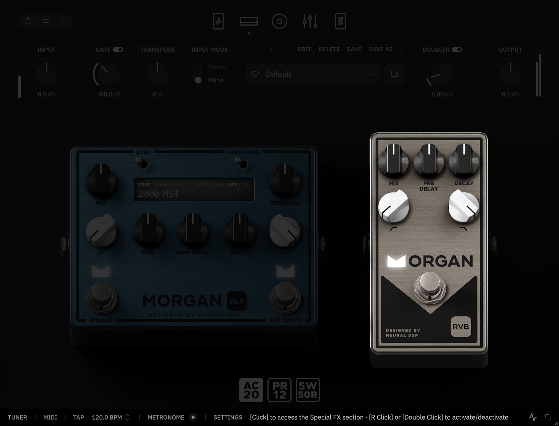

Post FX Section
This section consists of two time-based effects in series which can be used either separately or combined.

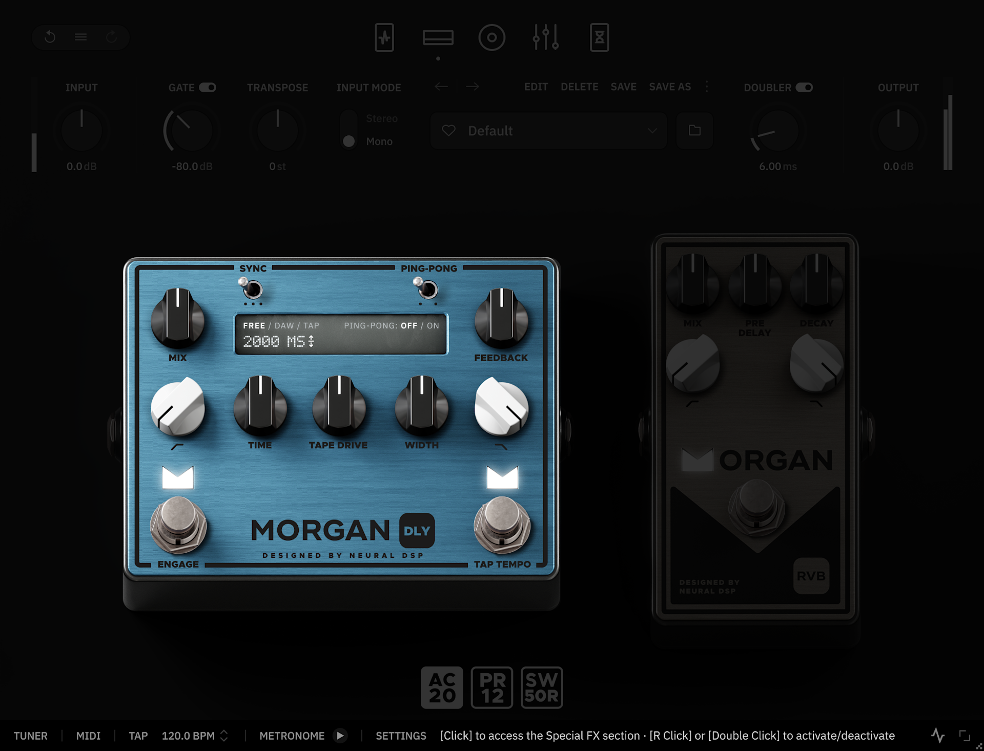

“DLY” - Delay Pedal
  1. Mix Knob: Adjusts the mix amount between the dry and the delayed signal.
  2. Feedback Knob: Controls how many times the echo repeats. Higher values create more repeats.
  3. Low Cut Knob: Cuts the low frequencies from the delayed signal. High settings produce a brighter sound.
  4. High Cut Knob: Cuts high frequencies from the delayed signal. Lower settings will give a darker sound.
  5. Time Knob: Sets how long it takes for the echo to repeat after the original sound.
  6. Tape Drive Knob: Adjusts the saturation amount applied to the delay repeats.
  7. Width Knob: Sets the delay spread among the left and right channels.
  8. Ping-Pong Switch: Enables ping pong to alternate delay repeats between left and right channels.
  9. Sync Switch: Selects delay timing mode: Free (manual), App/DAW tempo sync, or Tap tempo.
  10. Engage Stomp Switch: Click to activate/deactivate the DLY pedal.
  11. Tap Tempo Switch: Sets how long it takes for the echo to repeat after the original sound.
“RVB” - Reverb Pedal
  1. Mix Knob: Adjusts the mix amount between the dry and the reverberated signal.
  2. Pre Delay Knob: Sets the delay time before the reverberation begins.
  3. Decay Knob: Controls the length of the reverb tail.
  4. LPF Knob: Sets the cutoff frequency of the low-pass filter. Decrease to remove high frequencies.
  5. HPF Knob: Sets the cutoff frequency of the high-pass filter. Increase to remove low frequencies.
  6. Engage Stomp Switch: Click to activate/deactivate the RVB pedal.

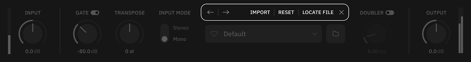

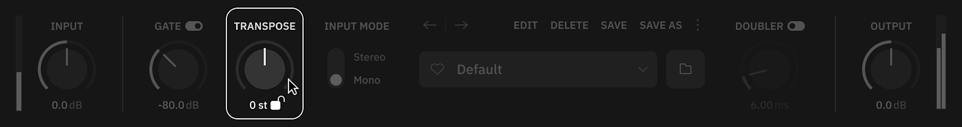

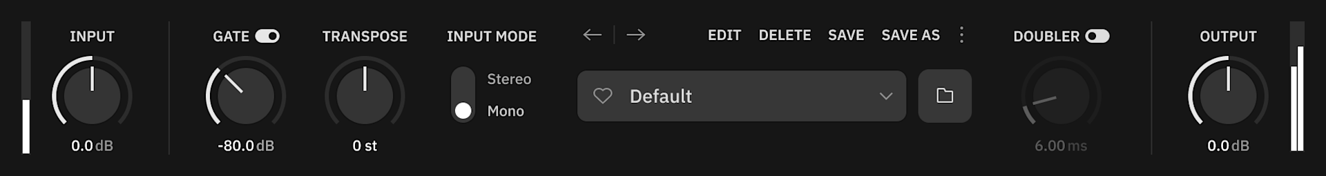

Utility Bar
Utility Bar in Plugins
  • Input Knob: Adjusts the level of the signal being fed into the plugin.
  • Gate Knob: The noise gate helps to reduce unwanted noise or hum in your signal. The level of audio signal will be reduced when it drops below the set value.
  • Transpose Knob: Transposes the signal up or down in pitch by a constant interval (+/-12 semitones). Use it to easily change the tuning of your instrument. The transpose module is bypassed at its default position (0 st).
  • Input mode Switch: Toggles between Mono and Stereo input processing. The Doubler is disabled while in Stereo Input Mode.
  • Doubler Knob: While in Mono Input mode, the doubler can simulate a larger stereo mode. The higher the value, the wider the stereo image is.
  • Output Knob: Adjusts the level of the signal the plugin feeds out.
Parameter Lock displayed while hovering on Transpose
All top-bar Utility Controls can be preserved across presets, just hover your mouse/cursor over to it to see the Lock icon.

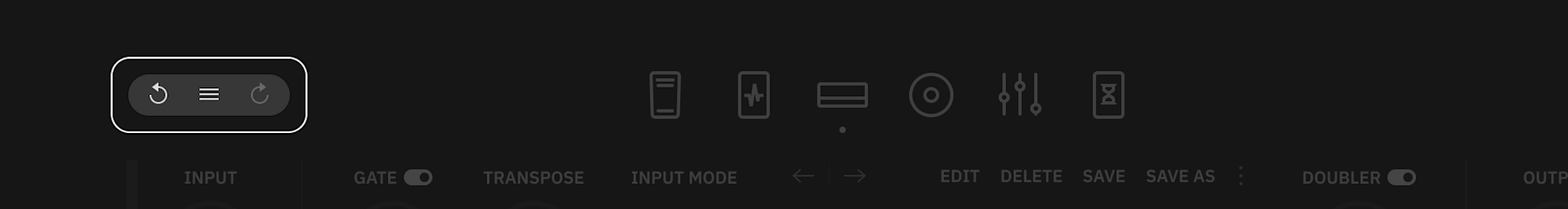

  • Undo/Redo and History: Revert or restore to a past state by using either the Undo/Redo icons, or by navigating the Action History list by clicking the History icon.

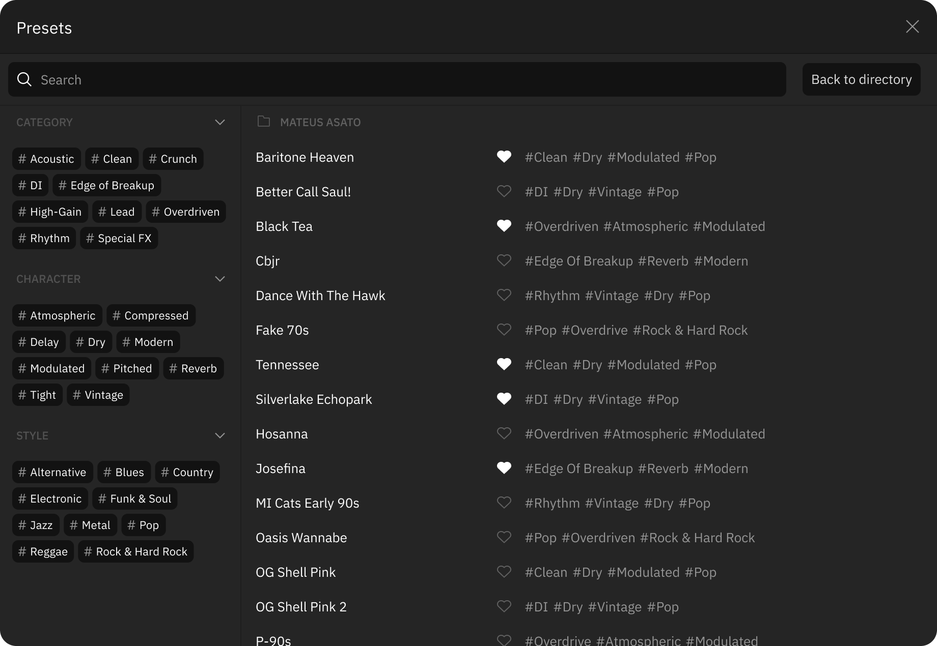

Preset Manager
A Preset is a saved configuration of settings and parameters that can be recalled instantly. Neural DSP factory presets are an excellent starting point for your tones. After loading a preset, you can fine-tune the parameters across the different sections of the plugin to create a new tone that suits your needs.
Presets you make can be organized into folders and subfolders, making it easier to find and manage them.
Utility Bar with Preset Bar highlighted
  • Preset Dropdown Menu: Quick preset access. Click to open a dropdown list of all the Presets available. Use the navigation arrows above to cycle through presets.
  • Favorite: Adds the selected preset to your favorites folder for quick access.
  • Preset Browser: Access to the full preset browser experience.
  • Edit: Only available for user presets, use it to update the selected preset's name or tags.
  • Delete: Click to delete the currently loaded preset (factory presets cannot be deleted)
  • Save: Used to update a preset with the latest changes (indicated by a dirty state: an *asterisk in the preset name).
  • Save As: Used to save the current configuration as a new user preset.
Clicking the More button (⋮) will display additional features:
Additional options for Preset bar
  • Import: Used to import Preset files from custom locations.
  • Reset: Click to make all parameters recall their default values.
  • Locate file: Click to find the preset's actual location in your computer. Neural DSP presets are stored as shareable, encrypted XML files.
What is an XML file?
XML, short for Extensible Markup Language, lets you define and store data in a shareable manner. Neural DSP presets are stored as encrypted XML files on your computer.
Saving Presets

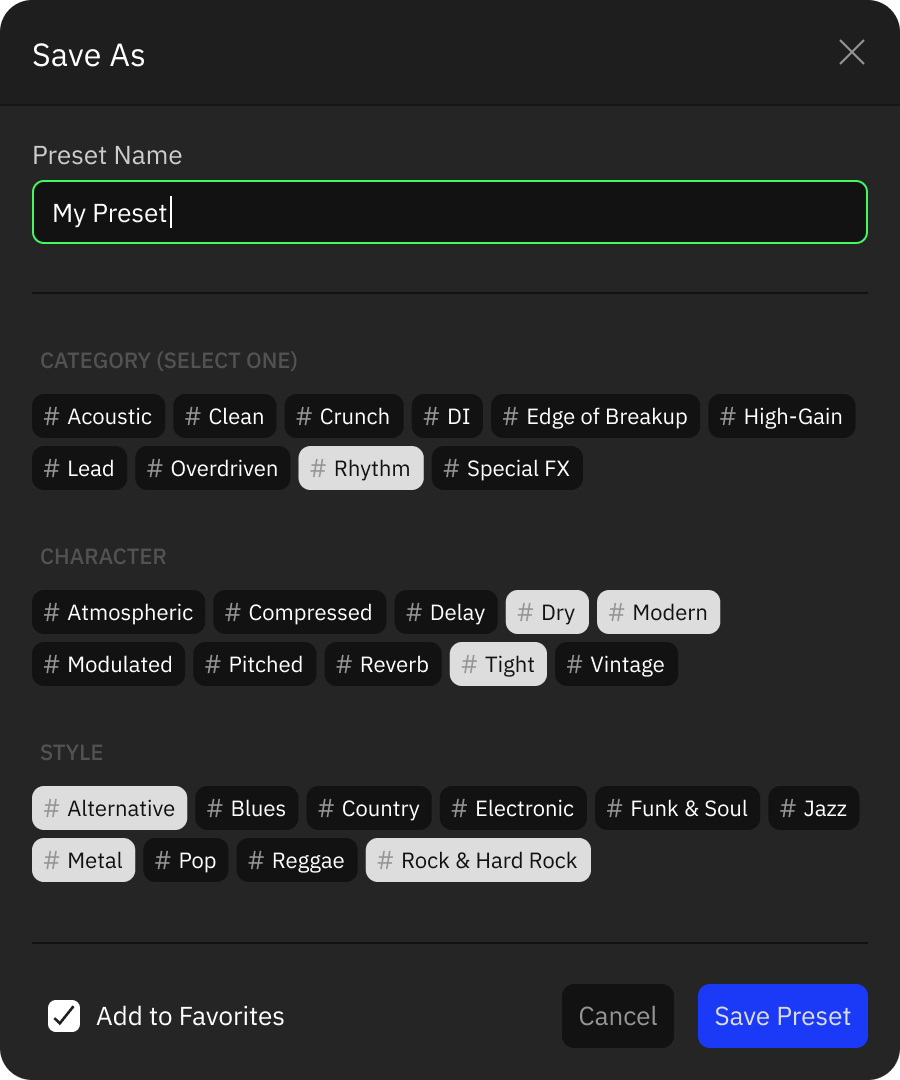

When creating or modifying sounds, you can save them as presets to access later on. The Save As window makes it easy to name, tag, and organize your presets.
Save As window with some preset tags selected
When saving a preset, the Save As window will appear with the following options:
  • Preset Name: Enter a custom name for your preset. By default, the name of the preset will match the name of the edited preset.
  • Tags: Add tags to make your presets easier to find. There are three types of tags available, each with fixed options: Category, Character, and Style.
    • Category: Choose a main category to describe the preset’s overall type (e.g. Clean, High-Gain, Lead, Rhythm, etc.) Only one category can be selected per preset.
    • Character: Add descriptive tags that define the tonal qualities or effects of the preset (e.g. Compressed, Atmospheric, Delay, Modulated, etc.) Multiple character tags can be applied.
    • Style: Select the musical style or genre the preset fits best (e.g., Metal, Pop, Jazz, Rock & Hard Rock, etc.). Multiple style tags can be applied.
  • Add to Favorites: Tick this box to automatically add the new preset to your favorites list for quick access.
About Tags
Factory presets are already tagged by default. For user presets, tags should be added manually during the saving process. Appropriate tagging helps when searching and filtering presets in the Preset Browser.

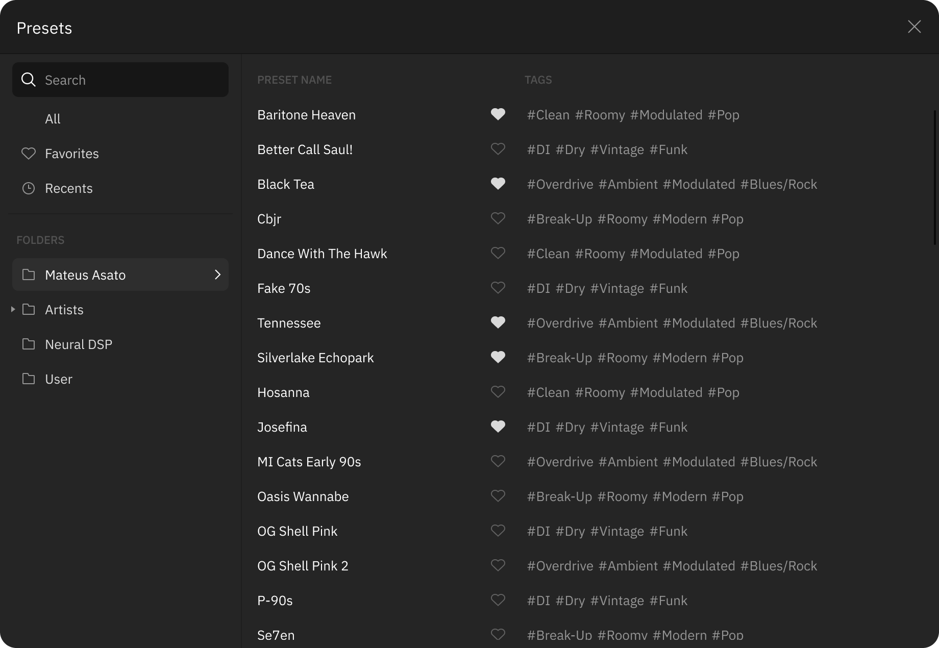

Preset Browser
Our plugins include a preset browser that makes it easier to organize, search, and filter presets. It can be accessed by clicking the Folder icon next to the Preset dropdown. The browser has two main views.
Directory View
Directory view of Preset Browser
The Directory view is a list of presets in their specific folder. In addition to all specific folders, you can see All, Recent and Favorite presets. The list includes Tags to help describe what each preset sounds like.
Search view
Preset browser search window
The Search view is accessed by clicking the Search Bar. You can either type in queries, or use the Tags to narrow down your search. The Locate icon will take you back to the folder where that specific preset is, for editing purposes.

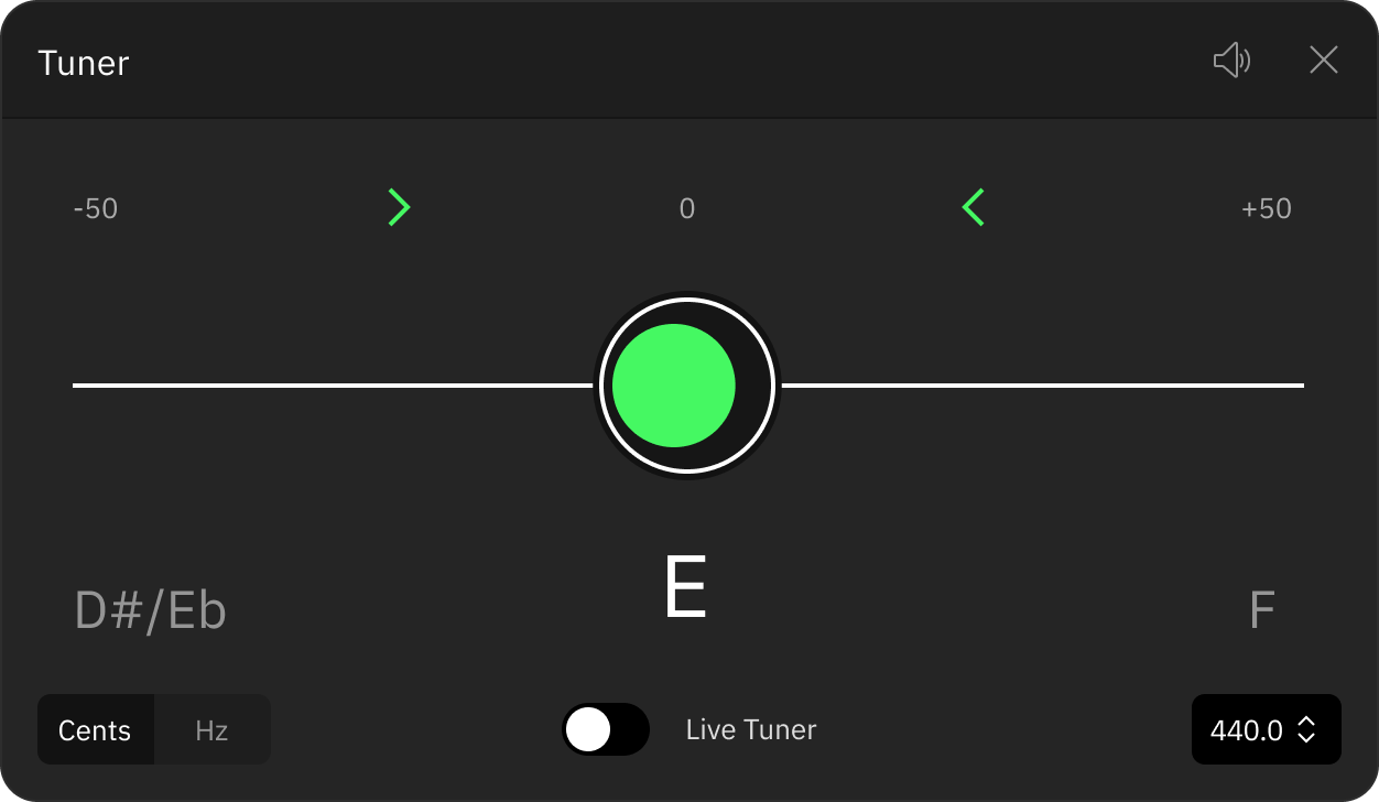

Tuner
Both standalone and plugin versions feature a built-in chromatic tuner. It works by detecting the pitch of the note that is being played and then displaying it on the screen.
Tuner window
  • Tuning: Displays the note that is being played and its current pitch.

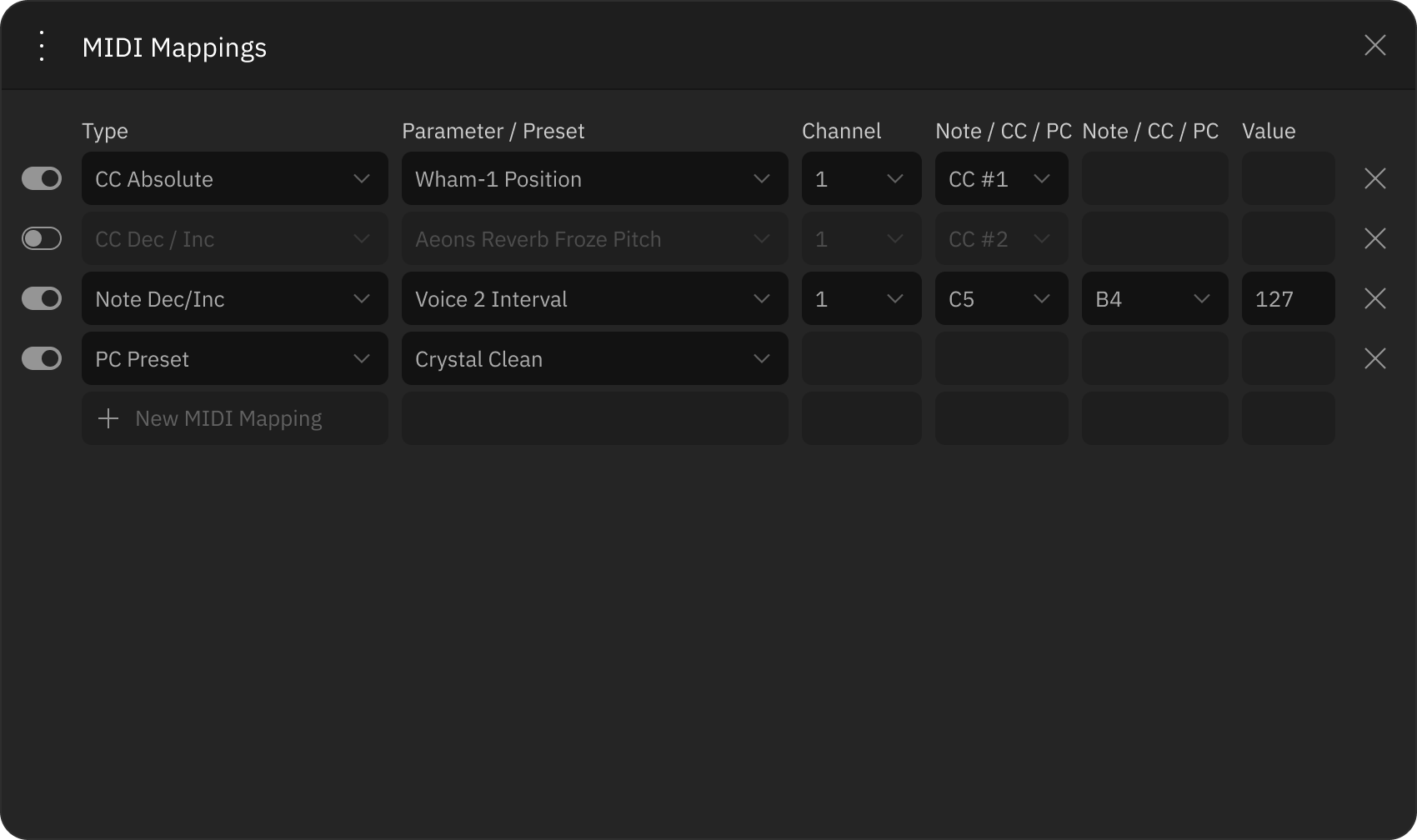

MIDI Learn
Using the MIDI Learn function is the quickest and easiest way to map MIDI messages on your plugin. To do so:
  1. Right-click a parameter that you wish to control and click Enable MIDI Learn.
  2. Press the button or move the pedal/slider on the MIDI controller that you want to use to control that parameter. The plugin will then automatically assign the button or pedal to the chosen parameter, which will now be highlighted in the interface.
  3. All the assigned MIDI messages will be registered in the MIDI Mappings window in the bottom bar.
MIDI Mappings
In the MIDI Mappings window, you can view and modify all the MIDI messages you have assigned to your plugin.
To add a new MIDI message, click on “New MIDI Mapping” located on the left side of the empty row. This will allow you to manually map a MIDI message to a parameter. You can also save and load MIDI Mapping Preset XML files.
midiMapping window

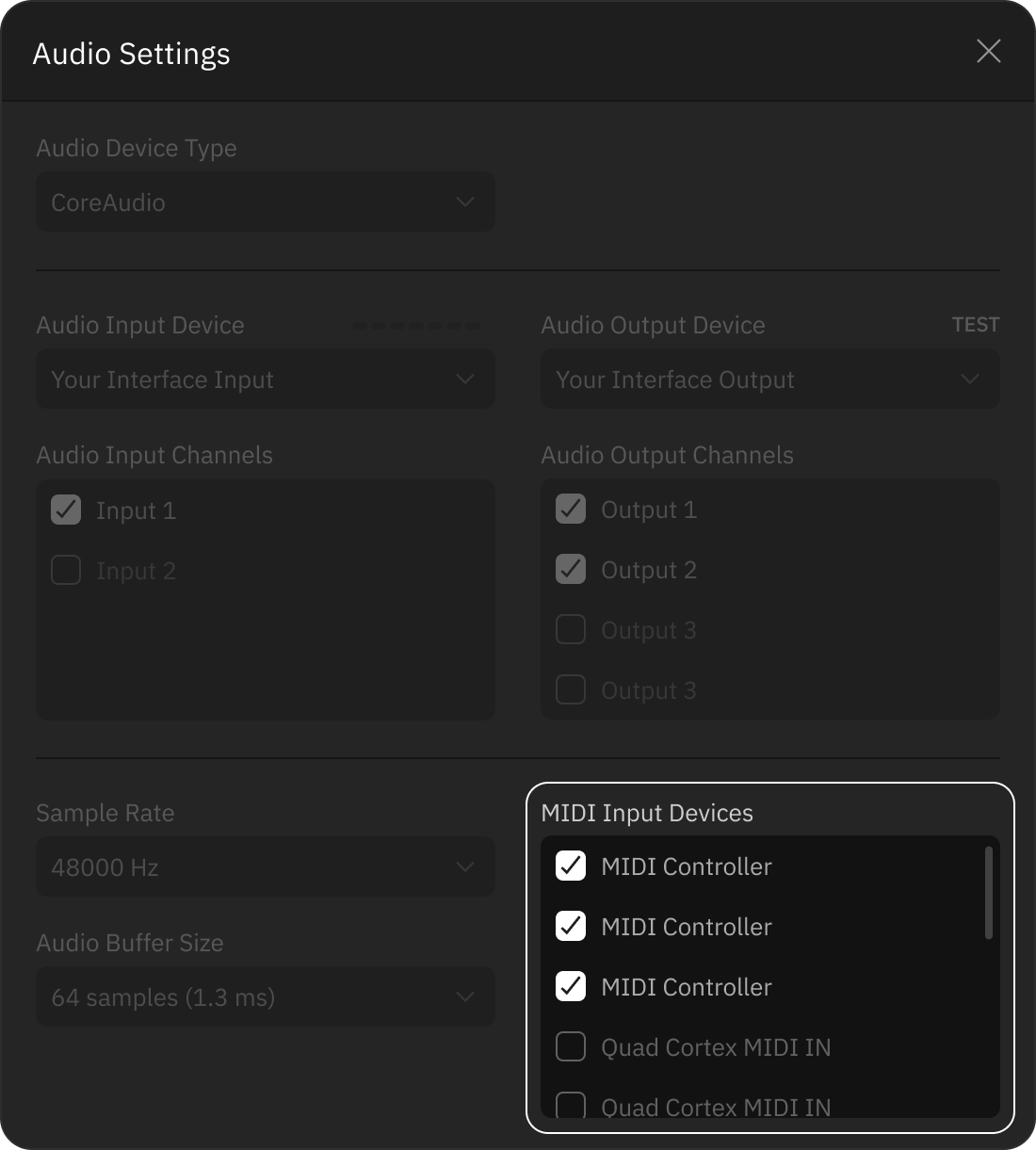

  • Audio device type: All available audio drivers on your computer are listed here. For most audio recording applications on Windows®, ASIO is the preferred driver format. CoreAudio is the recommended option on macOS®.
  • Audio device: Choose the audio interface that your instrument is connected to.
  • Audio input channels: Select the interface input(s) your instrument is connected to.
  • Audio output channels: Select the interface output(s) that you use for monitoring.
  • Sample rate: We recommend 48000 Hz unless a different rate is required for your session.
  • Audio buffer settings: Set it to 128 samples or lower. Increase the buffer size to 256 samples or higher if you experience performance issues.
