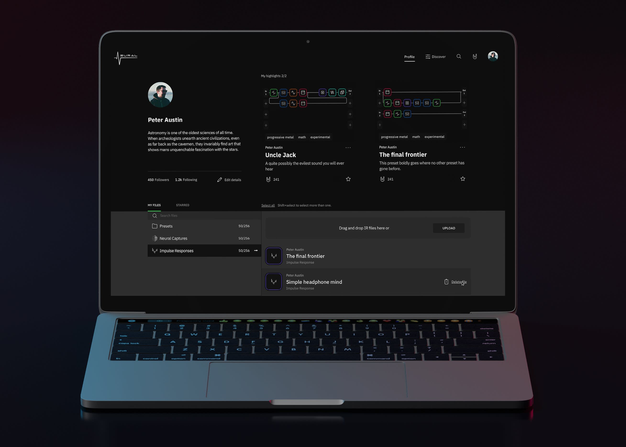

Quad Cortex has 256 slots for user IRs. Once you have paired your Quad Cortex to your Neural account, you can log in to Cortex Cloud to upload IRs. Navigate to your profile on Cortex Cloud and click “Impulse Responses” under “My Files”. The IRs on your Neural account will display here.

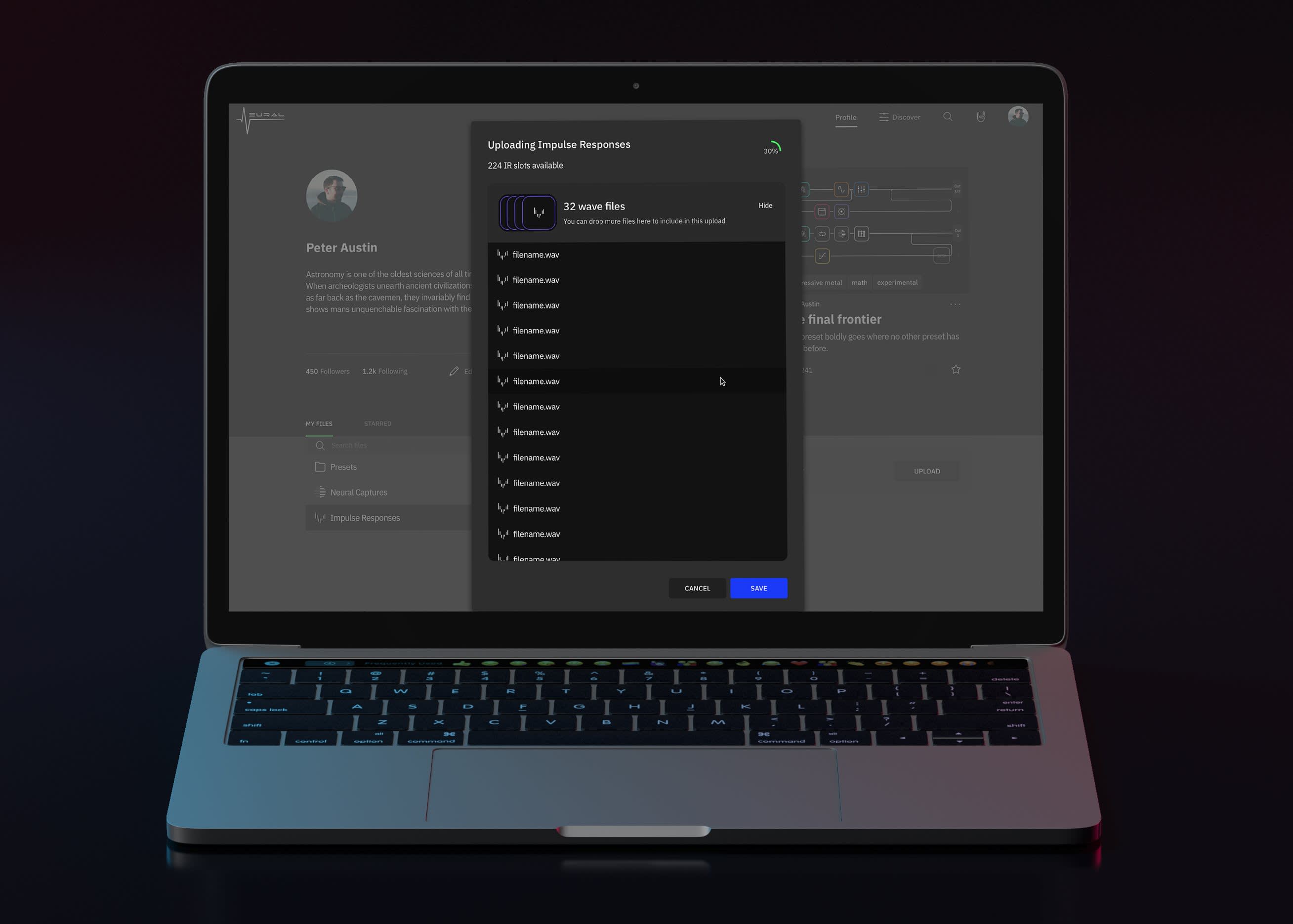

Drag-and-drop your IRs onto the upload box, and Cortex Cloud will process & verify them.
Once the upload is complete, the IRs will be available to download on your Quad Cortex. This process typically takes less than 2 minutes.

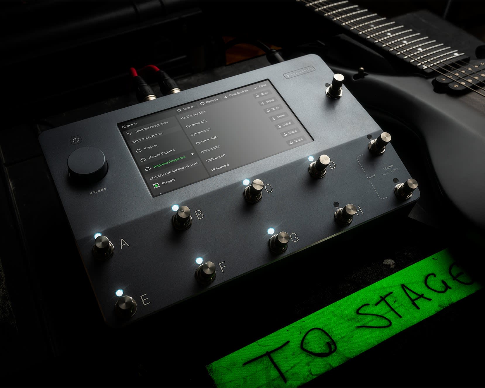

Custom IRs utilize the same interface as the factory IRs on Quad Cortex.
To load a custom IR, tap the IR currently being used in the Cabsim device, then tap "Load IR" to browse the Directory.
You can manage IRs in the Directory the same way you can manage Presets and Neural Captures.
