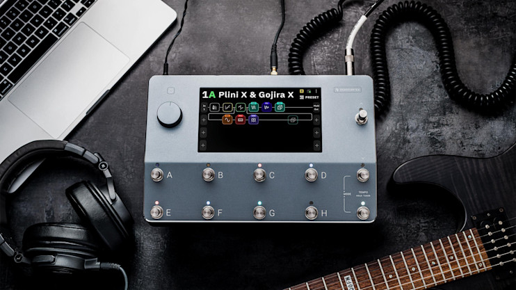

If you were signed into a Neural DSP account that has Archetype: Gojira X and Archetype: Plini X licenses linked to it prior to updating to CorOS 3.0.0, you will need to refresh the licenses on your Quad Cortex after the update.
You can do this by pressing the Refresh button within the 'Plugins' device list menu, pressing the Refresh button in the 'Plugin Presets' menu in the Directory, or by rebooting your Quad Cortex.
Your Neural DSP account can be used across three Quad Cortex units, and when CorOS 3.0.0 is released, you will be able to link 3 iLok accounts to your Neural DSP account.
4. Compatible plugins
Upon the release of CorOS 3.0.0, Archetype: Gojira X and Archetype: Plini X will be compatible with Quad Cortex. Visit our Plugins page to purchase licenses for these plugins.
