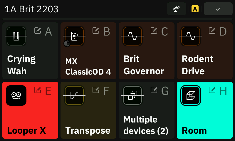

Press A, B, C, D, E, F, G, H footswitches to navigate Presets, Scenes, or toggle device blocks.

  • Press A, B, C, D, E, F, G or H to recall a Preset.
  • Press TEMPO to cancel ‘Blinking Mode’ and return to the currently loaded Preset.
Pressing BANK UP or BANK DOWN in SCENE or STOMP mode will navigate Presets Up or Down, respectively.

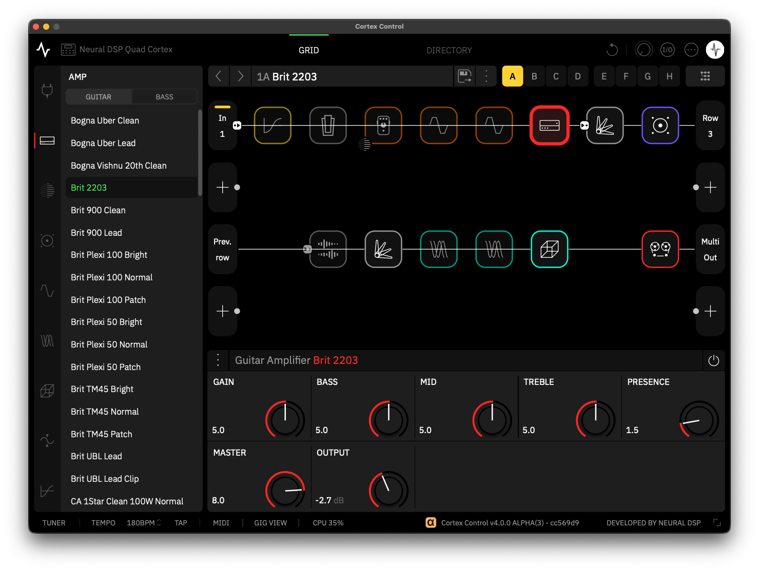

QC Param Editor Encoders
Tap a device block on The Grid to open its parameter editor. Turn A, B, C, D, E, F, G, H, BANK DOWN or TEMPO footswitch encoders to control assigned parameters. This feature is automatically enabled whenever controllable parameters are displayed on screen, such as Device Blocks, I/O Settings, Tuner, or Tempo menus.
QC Param Editor Cycle
When a virtual device parameter editor is open, turn the BANK UP encoder to cycle devices within the same category.

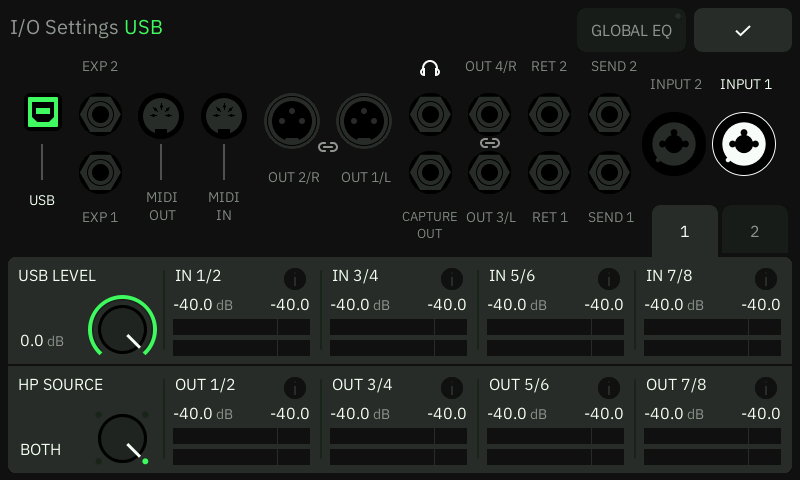

QC IO Settings Access
When in The Grid, swipe down from the top of the screen to access the I/O Settings menu.

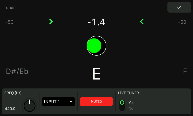

TUNER MENU
QC Tuner Menu 1
  • FREQ [Hz]: Sets the tuner reference pitch.
  • INPUT DROPDOWN: Determines which input will feed the Tuner.
  • MUTE: Tap to mute/unmute the input signal when the Tuner is active.
  • LIVE TUNER: Toggles the LIVE TUNER in Gig View.
While in the Tuner menu, press BANK UP to exit to The Grid.

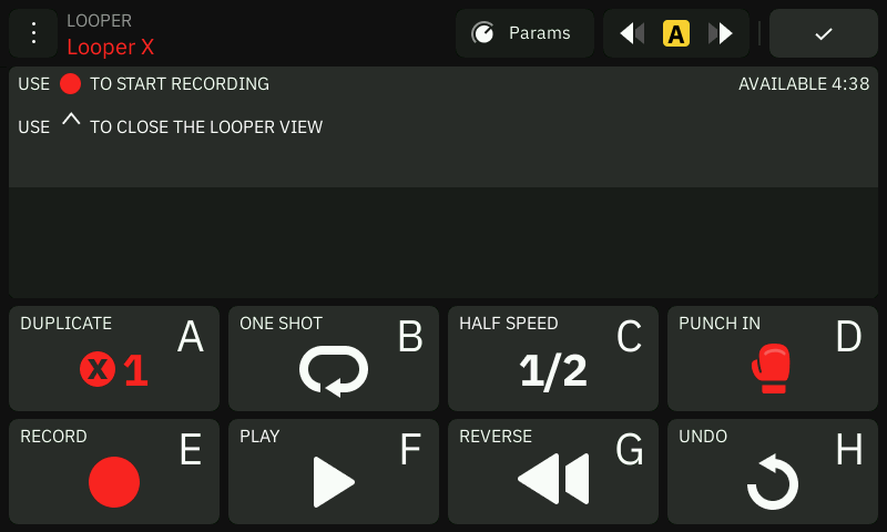

Metronome playback can also be triggered from the Looper X parameter menu. Additionally, if the Looper X’s PRE ROLL feature is enabled, the metronome will provide an audio cue before the loop recording begins.

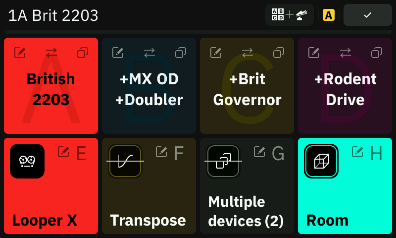

FOOTSWITCH ASSIGNMENTS
QC Stomp Assignment 3
STOMP Mode allows you to assign device blocks to footswitches so their bypass state can be toggled within the same Preset.
While in STOMP Mode, tap any device block on the Grid to access its parameter editor menu, then select Footswitch Assignment. Press the desired footswitch to complete the assignment.
A single footswitch can be assigned to multiple device blocks.

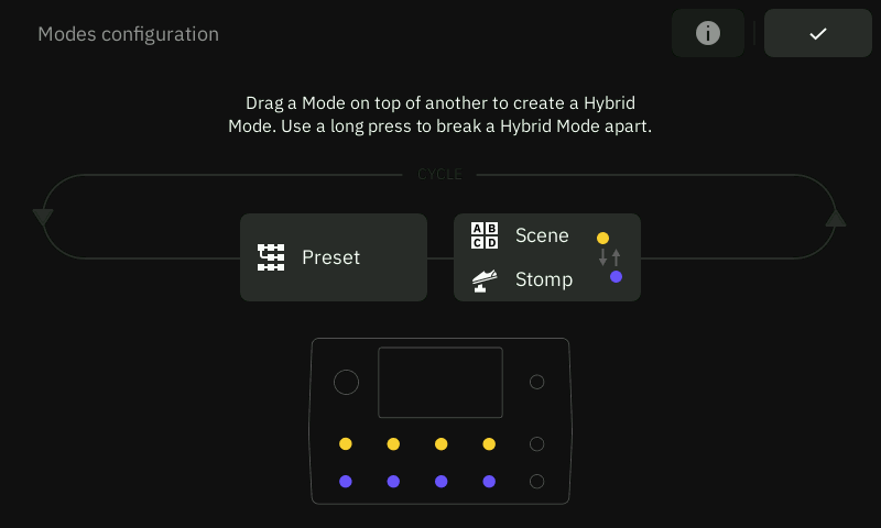

The Modes Configuration menu allows you to reorder the Modes cycle and create HYBRID Modes.
QC Modes Config Access 2
While in The Grid, tap and hold the MODE Indicator to access the Modes Configuration menu.
MODES CONFIGURATION MENU
QC Modes Config Menu 2
  • Drag-and-drop Modes to reorder them. This determines their sequence when cycling through Modes.
  • Drag one Mode onto another to merge them into a single slot, creating a HYBRID Mode. To split a HYBRID Mode, tap and hold it.
  • Drag Modes to the top-right corner to remove them. At least one Mode must remain in the cycle.
HYBRID MODE
QC Hybrid Stomps
HYBRID Mode allows you to assign different Modes to each horizontal row of footswitches within the same Preset (A to D and E to H).
While in the Modes Configuration menu, drag one Mode onto another to merge them into a single slot to create a HYBRID Mode. Tap the right edge of the HYBRID slot to swap the Modes rows.
HYBRID PRESET BANKS
When HYBRID Mode is configured with PRESET Mode, the Preset Banks are divided into two. This occurs because one row of two footswitches is assigned to a different Mode, leaving only a single row available for Preset selection, either A-D or E-H.

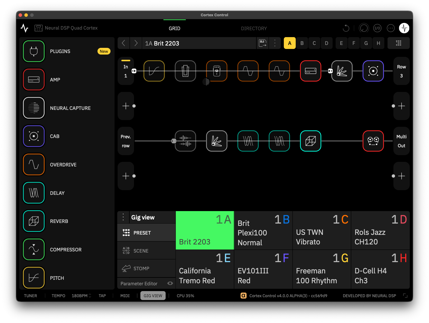

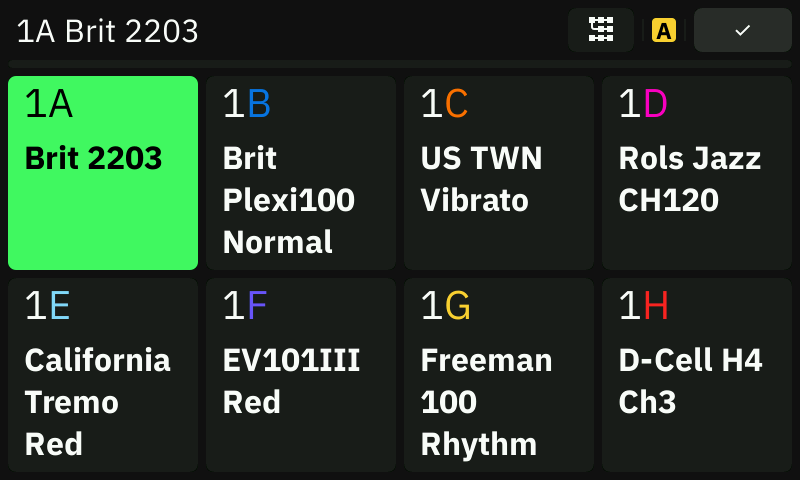

GIG VIEW: PRESET MODE
QC Gig View PRESET
While in PRESET Mode, Gig View displays Preset assignments for each footswitch.
GIG VIEW: SCENE MODE
QC Gig View SCENE
While in SCENE Mode, Gig View displays Scene assignments for each footswitch along with additional options:
  • EDIT SCENE: Customizes the selected Scene’s name and color.
  • SWAP SCENE: Exchange the selected Scene’s footswitch assignment with another Scene.
  • COPY SCENE: Duplicates the selected Scene.
GIG VIEW: STOMP MODE
QC Gig View STOMP
While in STOMP Mode, Gig View displays Stomp assignments for each footswitch along with additional options:
  • EDIT STOMP: Customizes the selected Stomp name and device block assignments.
  • PARAMETER EDITOR SHORTCUT: Tap a device block icon in Gig View to open its parameter editor on The Grid.
GIG VIEW: HYBRID MODE
QC Gig View HYBRID
While in HYBRID Mode, Gig View automatically adapts its layout to reflect the Modes included in the HYBRID configuration.

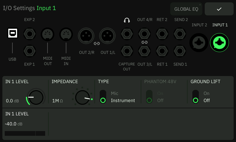

ANALOG AUDIO PORTS
IO Settings Analog
Quad Cortex features multiple audio inputs and outputs. The parameters in the editor panel adapt based on the selected I/O. Tap any analog audio port to adjust its parameters:
  • LEVEL: Adjusts the gain level of the selected I/O.
  • IMPEDANCE: Determines the combo inputs’ impedance value (1MΩ by default). Disabled when the TYPE switches are set to “Mic”.
  • TYPE: Determines the combo inputs’ mode. Set them to “Mic” when using XLR cables (“Instrument” by default).
  • PHANTOM 48V: Toggles phantom power for the combo inputs.
  • GROUND LIFT: Toggles ground lift on the selected I/O. Useful for reducing noise caused by ground loops.
  • MUTE: Mutes or unmutes the selected I/O.
  • OUTPUT PAIRING: Hold OUTPUTS 1/2 or 3/4 to pair or unpair them. Paired output will share LEVEL, GROUND LIFT, and MUTE parameter values.

USB AUDIO & MIDI PORTS
IO Settings USB
Quad Cortex provides 16 USB audio channels (8 inputs / 8 outputs). These channels are mapped to either host sources or device analog audio ports. Tap on a USB or MIDI port to adjust its parameters:
  • USB LEVEL: Adjusts the USB audio volume.
  • HP SOURCE: Selects which USB audio channels are routed to the headphones output.
  • DRY/WET: Determines whether USB Outputs 1/2 or 3/4 carry clean DI signals or processed audio.
  • MIDI THRU: Enables or disables the MIDI Thru feature.

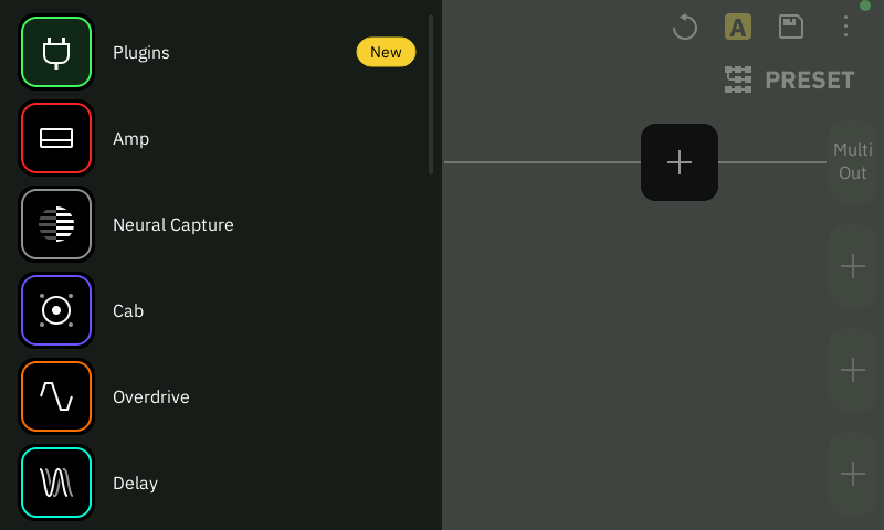

VIRTUAL DEVICE LIST
QC Empty Slot Tap
To begin building an audio signal chain, tap an empty slot on The Grid. This will open the Virtual Device List, which displays all device categories available.
Virtual Devices
QC Virtual Device List Amp
The Virtual Device List provides access to all virtual devices available that can be placed on The Grid. It allows you to browse by category, search for specific devices, and manage your favorites for quicker access.

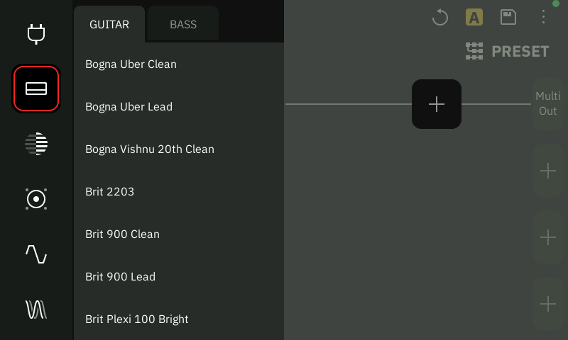

QC Virtual Devices 01
Once an empty slot on the Grid is selected, swipe vertically to browse virtual devices.
QC Virtual Devices 02
Tap Categories to expand or collapse them.
QC Virtual Devices 03
Tap a device to load it onto the Grid.
QC Virtual Devices 04
Tap and hold a device to pin it to the top of its respective category for quicker access.

EXPRESSION PEDAL CALIBRATION
To ensure accurate response across the full sweep range, it may be necessary to calibrate an expression pedal during first use.
HEEL TOE Switch 03
  1. Place the expression pedal on the surface where it will be used.
  2. Connect the expression pedal to the Quad Cortex EXP 1 or EXP 2 inputs using a TRS cable.
  3. Ensure the pedal is sitting flat on the surface, then access the I/O Settings menu (When in The Grid, swipe down from the top of the screen).
  4. Tap the EXP 1 input currently in use.
  5. Tap RECALIBRATE, then move the expression pedal fully from heel to toe.
  6. Verify that the POSITION indicator responds correctly, sweeping from 0.00 to 1.00.
  7. Tap SAVE to complete the calibration procedure.
The expression pedal calibration is stored as a global setting, remaining consistent across Presets, Scenes, and power cycles.

Looper X
The Looper X is a device block that, when placed on The Grid, captures and layers audio in real time, giving you full control over recording, overdubbing, playback, and more. While its position on The Grid determines whether the entire signal chain or only specific sections are recorded, custom routing options are also available.
QC Looper X Access
Tap the Looper X block to open its parameter editor.
LOOPER X ACTIONS
Looper X actions are displayed at the bottom of the screen, preassigned to A-H footswitches.
QC Looper X
To customize the footswitch layout, tap the Looper X contextual menu and select Assign Looper X Actions.
  • DUPLICATE: Creates an overdub that is twice the length of the original loop, allowing you to extend the loop during overdubbing. If THRESHOLD is enabled, this action also arms the Looper for recording.
  • RE-LOOP: Trims the length of the loop. This function is only available when DUPLICATE is active.
  • ONE SHOT: Plays the loop once, then stops. If activated during playback, the loop stops automatically after the recorded audio ends.
  • HALF SPEED: Plays the loop back at half the original speed.
  • PUNCH IN: Replaces the current loop audio with a new recording. Tap again to stop recording (PUNCH OUT).
  • RECORD: Starts recording a new loop. If THRESHOLD is enabled, this also arms the looper for recording. During playback, this control changes to OVERDUB.
  • OVERDUB: Records additional audio on top of the existing loop during playback.
  • PLAY/STOP: Starts or stops loop playback.
  • REVERSE: Reverses loop playback. If activated before playback begins, the loop will start in reverse after pressing PLAY.
  • UNDO: Reverts the last recording or overdub action. After using UNDO, the control changes to REDO.
  • REDO: Restores any actions previously undone with UNDO.
The Looper X actions and parameters can also be controlled via MIDI CC messages.
LOOPER X PARAMETERS
The Looper X parameters allow you to fine-tune playback, overdubbing, and overall loop behavior.
  • PLAYBACK LEVEL: Adjusts the overall playback volume of the loop playback.
  • OVERDUB LEVEL: Sets the playback level of the loop while overdubbing. For instance, a value of -5dB will reduce the volume by 5dB with each pass, gradually fading repeated overdubs.
  • HIGH PASS: Allows high frequencies to pass while cutting low frequencies from the loop playback.
  • LOW PASS: Allows low frequencies to pass while cutting high frequencies from the loop playback.
  • THRESHOLD: Enables automatic recording when an incoming audio signal is detected. This function is disabled when your device is receiving MIDI clock.
  • RECORD MODE: Sets the behavior of the RECORD function to Toggle or Momentary. In Momentary mode, recording is active only while its assigned Footswitch is held down.
  • OVERDUB MODE: Sets the behavior of the OVERDUB function to Toggle or Momentary. In Momentary mode, overdubbing is active only while its assigned footswitch is held down.
  • DUPLICATE MODE: Determines whether the DUPLICATE function is synced to the current tempo. When synced, loop length is locked to the tempo grid for rhythmic consistency. When unsynced, loop length is determined freely by user input.
  • PUNCH MODE: Sets the behavior of the PUNCH IN/OUT function to Toggle or Momentary. In Momentary mode, recording is active only while its assigned footswitch is held down.
  • ROUTING MODE: Configures the Input and Output routing for the Looper X block. The selected I/Os determine the audio path feeding the looper, allowing it to operate either as a Grid-based looper or a Global I/O looper.
  • QUANTIZE: Syncs the loop to the current tempo or an external MIDI Clock, based on the selected number of beats per bar.
  • MIDI CLOCK START: When enabled, receiving MIDI Clock messages automatically triggers the RECORD, DUPLICATE, and PLAY functions. This overrides the THRESHOLD recording feature.
  • PRE ROLL: Enables a metronome count-in of 1, 2, or 4 bars before transitioning into the next state, such as RECORD or PLAY. When enabled, a visual cue follows the metronome playback count-in before transitioning to RECORD or PLAY. The upper row of white squares reflects the number of beats per bar, based on the current metronome settings. The lower row of green squares represents the number of PRE ROLL bars selected.
  • METRONOME PLAYBACK: Toggles the metronome playback on or off.
  • RECORDING LENGTH: Sets a fixed loop recording length, adjustable from 1 to 32 bars.

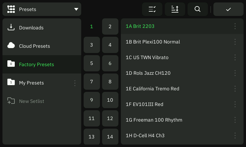

PRESETS
QC Directory Presets
Presets are organized into Setlists, folders capable of storing up to 256 Presets. You can store up to 3072 user Presets on your device.
  • DOWNLOADS (PRESETS): Contains all the Presets you have downloaded from other users via the Cortex Cloud app.
  • CLOUD PRESETS: Contains all the Presets you have uploaded to your Cortex Cloud profile.
  • FACTORY PRESETS: Contains Factory Presets made by Neural DSP (Non-deletable).
  • MY PRESETS: Default User Preset Setlist (Non-deletable).
  • NEW SETLIST: Tap to create a new User Setlist. You can create up to 10 User Setlists, which can be renamed or deleted.
  • BANKS: Presets are organized into banks for easier navigation. By default, each bank contains four Presets. When a HYBRID Mode that includes PRESET Mode is active, each bank contains two presets instead.

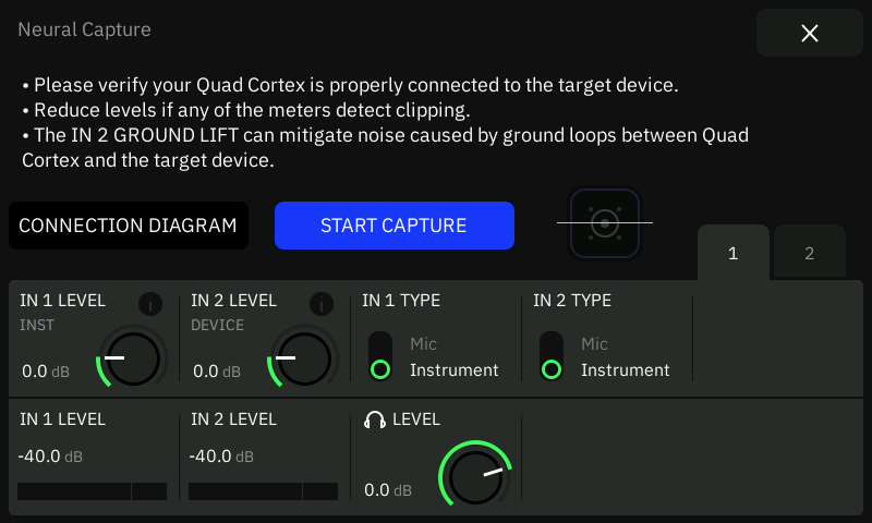

Calibration Settings
QC Capture Settings
Before starting the Neural Capture process, ensure the microphone position and target device settings are adjusted to your preference. Reduce input levels if any meters indicate clipping.
  • IN 1 LEVEL: Adjusts the input gain of the instrument signal. Adjust this level as you would in The Grid to properly feed the target device while playing your instrument. This setting is for monitoring purposes only and does not affect the CAPTURE OUT training signal level.
  • IN 2 LEVEL: Adjusts the input gain coming from the target device signal. For optimal results, aim for a peak level around -12 dB.
  • HP LEVEL: Adjusts the headphones' output level.
  • IN 1 METER: Displays the instrument input signal level.
  • IN 2 METER: Displays the target device signal level.
  • IN 2 GROUND LIFT: Toggles the ground lift on INPUT 2/CAPTURE INPUT. This feature helps to reduce unwanted noise by interrupting the ground loops coming from external sources.
  • IN 2 PHANTOM: Toggles 48V Phantom Power for compatible microphones.
  • OUT 1 GND LIFT: Toggles the ground lift on OUTPUT 1L. This feature helps to reduce unwanted noise by interrupting the ground loops coming from external sources.
  • OUT 2 GND LIFT: Toggles the ground lift on OUTPUT 2R. This feature helps to reduce unwanted noise by interrupting the ground loops coming from external sources.
  • CAPTURE CAB/IR LOADER BLOCK: Tapping the Cab block opens the Capture Cab/IR Loader parameter editor, allowing you to audition the target device with a cabinet or an impulse response (IR). Both the Cab and IR Loader blocks function exactly as they do on The Grid and can be bypassed if you prefer to audition your target device without additional processing.
Tap START CAPTURE to begin the Neural Capture process.

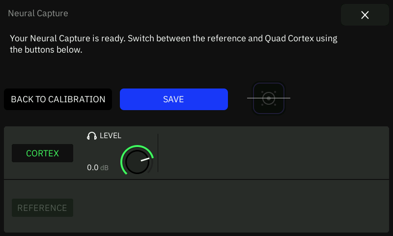

A/B TEST
Once the capture process is complete, your Neural Capture will be ready for testing. You can easily A/B compare the sound of the original device with the Neural Capture to ensure accuracy.
QC Capture V1 AB Test
  • A/B TOGGLE: Tap to toggle between the original device signal and the Neural Capture.
  • RESTART CAPTURE: Redo the Neural Capture process.
When you are satisfied with the results, tap SAVE to store your recently created Neural Capture.
SAVE NEURAL CAPTURE
Tap SAVE to store your recently created Neural Capture.

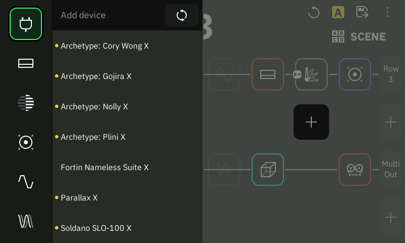

Plugin Compatibility
Plugin Licenses
Logging in to your Neural DSP account on the Quad Cortex verifies which Neural DSP plugin licenses are associated with your linked iLok account(s) and unlocks any plugin devices on your device.
Neural DSP Profile 2024b
You can link up to three iLok accounts to your Neural DSP account. All purchased Neural DSP licenses are automatically deposited into your primary iLok account. Unlocking plugin devices on the Quad Cortex does not affect the number of activations available on iLok License Manager.
  • 14-day trials are not valid perpetual licenses.
  • An internet connection is only required once to verify perpetual plugin licenses.
  • As a security measure, a plugin license can be activated on up to three Quad Cortex and three Quad Cortex mini devices per Neural DSP account. If this limit is reached, plugin device blocks will appear locked in the Virtual Device List and will be bypassed on the fourth device linked to the same account.
Plugin Licenses Offline Support
Once validated, plugin licenses remain available on your device even when it is offline. Their status will only change if you link a different Neural DSP account to the device.
Plugin Devices
Plugin device blocks are located in the ‘Plugins’ category within the Device List.
QC Plugin Devices List
Blocks are organized into folders by plugin. Tap a folder to expand plugin device blocks. When you tap a device block in the Device List, it is automatically loaded into the previously selected slot on The Grid.
QC Plugin Refresh
Tap REFRESH to update the plugin availability status in the Virtual Device List. Plugin blocks will unlock automatically when a valid license is detected in your account. Plugins you do not own will remain locked in the Virtual Device List and cannot be loaded onto The Grid.

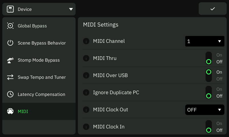

MIDI Support
Quad Cortex supports MIDI via USB-B and MIDI DIN.
MIDI Settings
QC Grid Settings
To access the MIDI settings, tap the Grid’s Contextual Menu at the top-right corner and select Settings > Device > MIDI.
QC MIDI Settings
  • MIDI CHANNEL: Determines the MIDI input channel that Quad Cortex will respond to. Select OMNI to receive MIDI messages from all channels.
  • MIDI THRU: MIDI Thru allows multiple devices to be connected in series, enabling them to receive MIDI data from a single common source. When enabled, Preset MIDI Out messages will be disabled.
  • MIDI OVER USB: Enable or disable MIDI communication via USB.
  • IGNORE DUPLICATE PC:
    • ON: When enabled, prevents Presets from being reloaded if the same MIDI Program Change (PC) message is received repeatedly. Related messages such as CC#0 and CC#32 will also be ignored.
    • OFF: Presets will be reloaded each time the corresponding MIDI Program Change (PC) message is received.
  • MIDI CLOCK OUT: Tap to toggle ‘MIDI Clock Out’ through USB and/or TRS MIDI on or off. To send MIDI Clock via USB, ‘MIDI Over USB’ must be enabled.
  • MIDI CLOCK IN: Tap to toggle ‘MIDI Clock In’ through USB or TRS MIDI on or off. To receive MIDI Clock via USB, ‘MIDI Over USB’ must be enabled.
MIDI Clock Behavior
The Tempo LED turns red when your device is sending MIDI Clock and turns blue when it is receiving MIDI Clock.

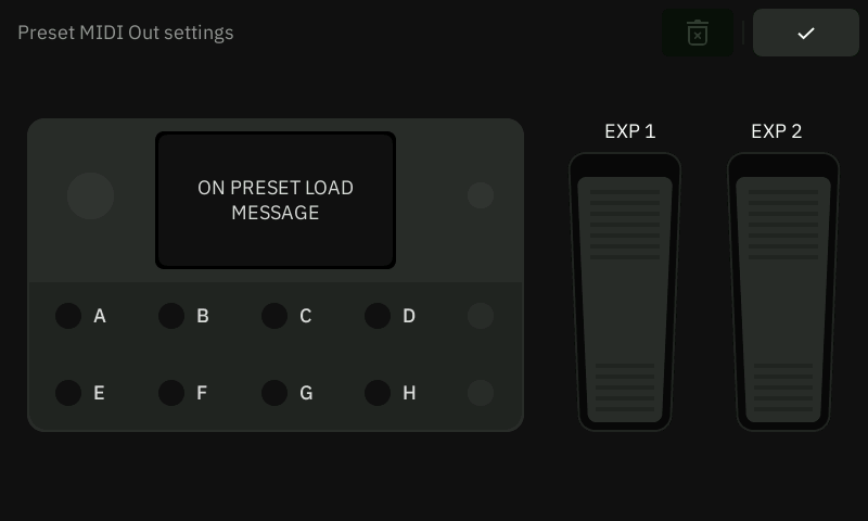

Preset MIDI Out
Quad Cortex can send MIDI messages to external devices via USB or MIDI DIN when assigned footswitches are pressed or upon Preset load.
QC MIDI Out Access
Tap the Grid’s Contextual Menu at the top-right corner and select Preset MIDI Out.
QC MIDI Out
FOOTSWITCH & EXPRESSION MESSAGES
You can assign up to 12 MIDI messages per footswitch (A-H) that will be sent via USB and/or MIDI DIN simultaneously upon pressing a designated footswitch.
Tap any Footswitch or Expression Pedal in the Preset MIDI Out menu to view and edit its MIDI message assignments.
  • TYPE: Sets the type of MIDI message sent (CC, CC Toggle, or PC).
  • CHANNEL: Sets the MIDI channel used to send the message (1 to 16).
  • CC#: Sets the Control Change number for the CC message (0 to 127).
  • BANK CC#0: Sets the Bank Select MSB for the PC message (Most Significant Byte).
  • BANK CC#32: Sets the Bank Select LSB for the PC message (Least Significant Byte).
  • VALUE: Sets the value for the assigned CC message (0 to 127).
  • MIN/MAX VALUE: Sets the value range for the assigned CC Toggle message (0 to 127).
  • PROGRAM#: Sets the program value for the assigned PC message (0 to 127).
MIDI Out Behavior
  • Footswitch MIDI messages are sent only when SCENE, STOMP, or HYBRID modes are active.
  • Expression Pedal MIDI messages are always sent, regardless of the active mode.
ON PRESET LOAD MESSAGES
You can assign up to 12 MIDI messages per Preset that will be sent via USB and/or MIDI DIN simultaneously once the current Preset is loaded.
Tap ON PRESET LOAD MESSAGE in the Preset MIDI Out menu to view and edit the current Preset MIDI message assignments.

MIDI & Modes Cycling
When Modes are reordered in the Modes Configuration menu, MIDI CC values do not change to reflect the new cycle arrangement. If a Mode slot is empty, MIDI messages will not recall any Mode.
LOOPER X CONTROL
CC#48: Looper X.
• Value 0-63: Opens the Looper X parameter editor (‘Perform’ Mode).
• Value 64-127: Closes the Looper X parameter editor.
CC#49: Duplicate (Looper X).
• Value 64-127: Toggles DUPLICATE on and off.
CC#50: One Shot (Looper X).
• Value 64-127: Toggles ONE SHOT on and off.
CC#51: Half Speed (Looper X).
• Value 64-127: Toggles HALF SPEED on and off.
CC#52: Punch In/Out (Looper X).
• Value 0-63: PUNCH OUT.
• Value 64-127: Toggles PUNCH IN / PUNCH OUT.
0-63 Value Behavior
Value 0-63 works as long as the parameter is set to momentary and value 0-63 is sent upon the MIDI footswitch’s release.
CC#53: Record/Overdub (Looper X).
• Value 0-63: STOP active recording.
• Value 64-127: Toggles RECORD / OVERDUB.
0-63 Value Behavior
CC#54: Play/Stop (Looper X).
• Value 64-127: Toggles PLAY / STOP.
CC#55: Reverse (Looper X).
• Value 64-127: Toggles REVERSE on and off.
CC#56: Undo/Redo (Looper X).
• Value 64-127: Toggles UNDO / REDO.

USB Channels
Quad Cortex has 16 USB Audio Channels (8 Inputs / 8 Outputs).
USB INPUTS
USB INPUT 1 (DRY INPUT 1)
• Source
: Analog INPUT 1.
• Description: Dry Input (D.I.) signal from analog INPUT 1 to the host. Select INPUT 1 on your DAW to record the dry input signal coming from your instrument.
USB INPUT 2 (DRY INPUT 2)
• Source
: Analog INPUT 2.
• Description: Dry Input (D.I.) signal from analog INPUT 2 to the host. Select INPUT 2 on your DAW to record the dry input signal coming from your instrument or microphone.
USB INPUT 3 (WET SIGNAL L)
• Source
: Analog OUTPUT 1/L.
• Description: Processed signal from analog Output 1/L to the host. Select INPUT 3 on your DAW to record the processed audio signal from The Grid.
USB INPUT 4 (WET SIGNAL R)
• Source
: Analog OUTPUT 2/R.
• Description: Processed signal from analog Output 2/R to the host. Select INPUT 4 on your DAW to record the processed audio signal from The Grid.
USB INPUT 5 (GRID’S USB OUTPUT 5)
• Source
: Grid’s USB OUTPUT 5.
• Description: Processed signal from Grid’s USB Output 5 to the host. Select INPUT 5 on your DAW to record the processed audio from this specific output block.
USB INPUT 6 (GRID’S USB OUTPUT 6)
• Source
: Grid’s USB OUTPUT 6.
• Description: Processed signal from Grid’s USB Output 6 to the host. Select INPUT 6 on your DAW to record the processed audio from this specific output block.
USB INPUT 7 (GRID’S USB OUTPUT 7)
• Source
: Grid’s USB OUTPUT 7.
• Description: Processed signal from Grid’s USB Output 7 to the host. Select INPUT 7 on your DAW to record the processed audio from this specific output block.
USB INPUT 8 (GRID’S USB OUTPUT 8)
• Source
: Grid’s USB OUTPUT 8.
• Description: Processed signal from Grid’s USB Output 8 to the host. Select INPUT 8 on your DAW to record the processed audio from this specific output block.
USB OUTPUTS
USB OUTPUT 1 (TO OUT 1/L)
• Source
: Host’s Left Output.
• Description: Playback signal from the host to OUTPUT 1/L. Select OUTPUT 1 on your DAW to route the host playback to OUTPUT 1/L.
USB OUTPUT 1 (TO OUT 2/R)
• Source
: Host’s Right Output.
• Description: Playback signal from the host to OUTPUT 2/R. Select OUTPUT 2 on your DAW to route the host playback to OUTPUT 2/R.
USB OUTPUT 3 (TO OUT 3/L)
• Source
• Description: Playback signal from the host to OUTPUT 3/L. Select OUTPUT 3 on your DAW to route the host playback to OUTPUT 3/L.
USB OUTPUT 4 (TO OUT 4/R)
• Source
• Description: Playback signal from the host to OUTPUT 4/R. Select OUTPUT 4 on your DAW to route the host playback to OUTPUT 4/R.
USB OUTPUT 5 (GRID’S USB INPUT 5)
• Source
: Host’s USB OUTPUT 5.
• Description: Playback signal from the host to USB OUTPUT 5. Select USB INPUT 5 on any input block to route the processed audio from the host to The Grid.
USB OUTPUT 6 (GRID’S USB INPUT 6)
• Source
: Host’s USB OUTPUT 6.
• Description: Playback signal from the host to USB OUTPUT 6. Select USB INPUT 6 on any input block to route the processed audio from the host to The Grid.
USB OUTPUT 7 (GRID’S USB INPUT 7)
• Source
: Host’s USB OUTPUT 7.
• Description: Playback signal from the host to USB OUTPUT 7. Select USB INPUT 7 on any input block to route the processed audio from the host to The Grid.
USB OUTPUT 8 (GRID’S USB INPUT 8)
• Source
: Host’s USB OUTPUT 8.
• Description: Playback signal from the host to USB OUTPUT 8. Select USB INPUT 8 on any input block to route the processed audio from the host to The Grid.
USB Dry/Wet Swap
When enabled, toggles between sending dry (unprocessed) or wet (processed) signal to USB channels 1/2 and 3/4. Channel names on your computer will update after reconnecting or power cycling your device.
This feature is available in the I/O Settings menu.

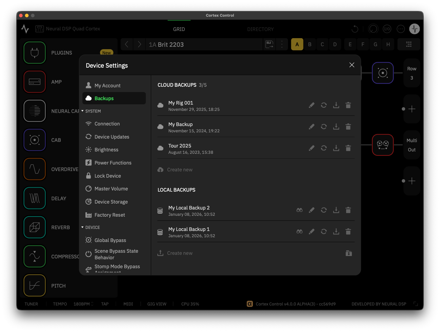

Account Settings
Manage your Cortex Cloud and backup data. This section lets you sign in or out, view your account details, and manage backups stored in the cloud.
QC Settings Account
  • MY ACCOUNT: View and manage your Cortex Cloud™ account.
  • BACKUPS: Manage and restore backups stored in the cloud.

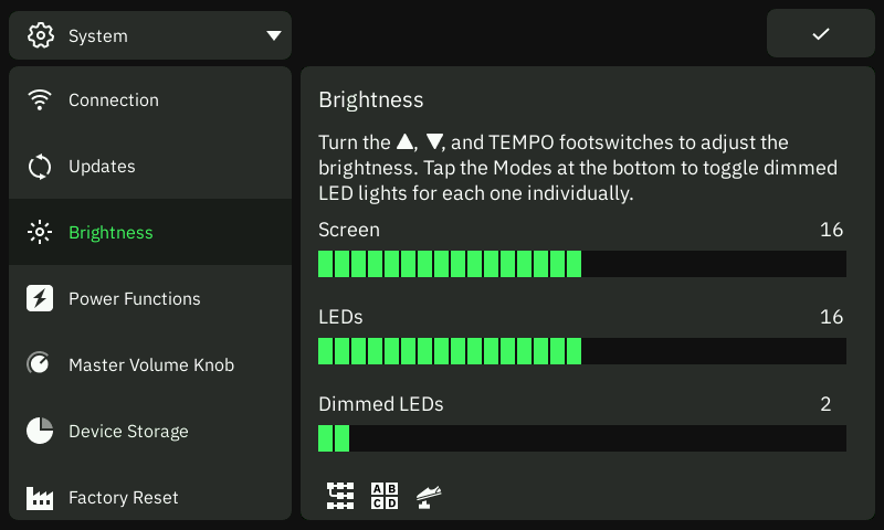

  • BRIGHTNESS: Adjust screen and LED brightness settings.

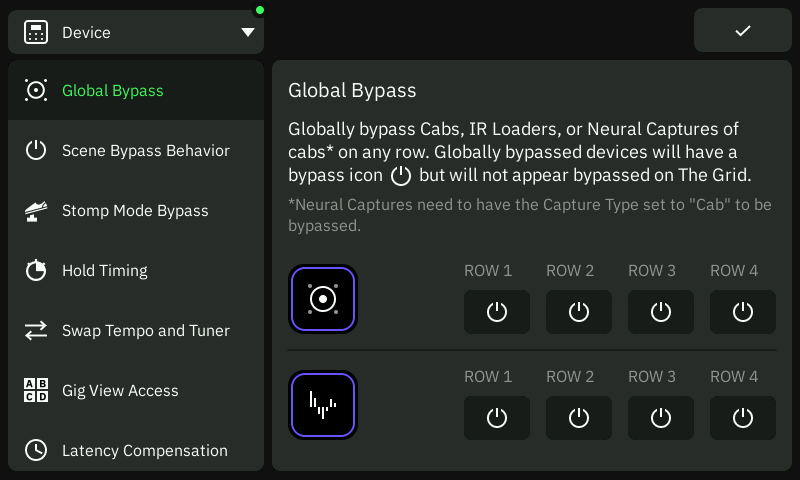

Device Settings
Configure how the Quad Cortex behaves during performance. Adjust global audio settings, footswitch behavior, latency, and MIDI control. These options directly affect how you interact with Presets, Scenes, and external MIDI devices.
QC Settings Device 2
  • GLOBAL BYPASS: Enable or disable Cab and IR Loader blocks across all Presets for selected Rows in The Grid.
  • SCENE BYPASS BEHAVIOR: Select how block bypass states are managed when working with Scenes:
    • Always overwrite bypass state (default): All block bypass changes are automatically saved per Scene.
    • Footswitch Presses are not saved: Block bypass changes made via footswitches in STOMP Mode are not saved. Changes made via the touchscreen are saved.
    • No changes are saved: Block bypass changes made by any method are not saved.
  • STOMP MODE BYPASS: Select whether blocks are automatically assigned or not to footswitches for STOMP Mode operation once they are loaded onto The Grid.
  • HOLD TIMING: Determine how long a footswitch must be held to trigger its assigned HOLD action, with a range from 500 ms to 1000 ms.
  • SWAP TEMPO AND TUNER: Swap the footswitch combinations for accessing the Tempo and Tuner menus. When enabled:
    • Press TEMPO twice to open the Tuner menu.
    • Hold TEMPO to open the Tempo menu.
  • GIG VIEW ACCESS: Allows you to hold BANK DOWN + TEMPO to toggle Gig View. When enabled, Mode cycling is triggered when the footswitches are released.
  • LATENCY COMPENSATION: Toggles Dynamic latency Compensation. Disabling this feature may help prevent phase issues when bypassing devices in The Grid.
  • MIDI: Configure MIDI channel, MIDI Thru, MIDI over USB, and MIDI Clock settings.

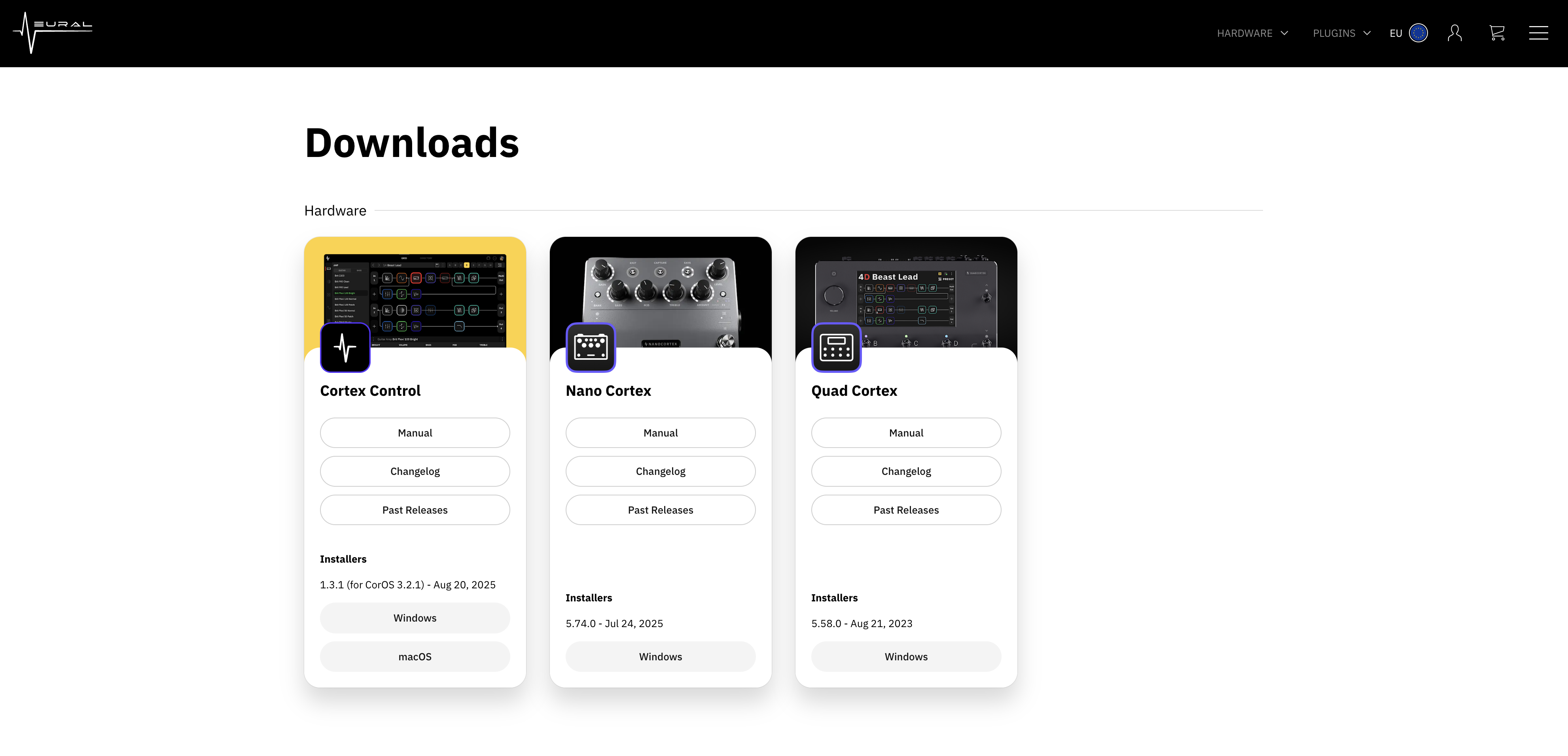

INSTALLATION
Download the latest version of Cortex Control from our official website and run the installer to complete the installation process. Cortex Control is available for both macOS® and Windows®.
UPDATES
To update Cortex Control, download the latest version from the official website and run the installer. There is no need to uninstall the previous version, as your existing files will be automatically overwritten during the installation process.

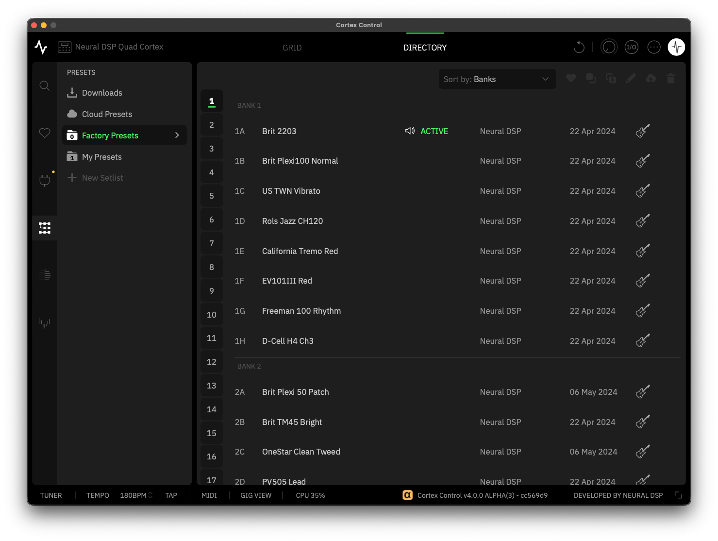

User Interface
The Cortex Control user interface provides a streamlined, desktop-based experience for managing every aspect of your Quad Cortex.
From the main window, you can access The Grid, browse and organize content via the Directory, and adjust device settings.
GRID
QC Control Grid 1b
Cortex Control features an intuitive and expanded version of The Grid, giving you a clear overview of the current active Preset. The Grid displays your virtual devices, signal routing, parameter values, active Scene, Tempo, and CPU usage.
QC Control Empty Slot
You can start building a Preset by clicking an empty slot on The Grid to add your first device block from the Virtual Device List. Additionally, you can drag-and-drop devices directly from the Virtual Device List onto The Grid.
Parameter Editors
The Parameter Editors expand or collapse depending on the selected item. The Grid always remains visible to ensure an uninterrupted editing experience.
DIRECTORY
QC Control Directory 1b
The Directory provides a complete overview of all your content, including Presets, Neural Captures, Impulse Responses, and Plugin Presets. The Directory is designed for fast navigation, allowing you to browse, search, and manage all factory and user content on your device.
QC Control Directory Management
From the Directory, you can load items, upload or download content to and from Cortex Cloud, and organize your library using folders, setlists, and subfolders. You can also favorite, rename, duplicate, or delete content directly from the Directory interface.
Contextual Menus
Right-click items on the Directory to quickly access relevant actions while keeping the Directory view visible for seamless content management.
BOTTOM UTILITY BAR
QC Control Utility Bar
The bottom utility bar in Cortex Control provides quick access to essential tools, making it easy to switch between views and adjust settings without leaving The Grid or Directory.
  • TUNER: Click to open the Tuner menu.
  • TEMPO: Click to access the Tempo and Metronome menu. You can set tempo values per Scene, Preset, or globally.
  • BPM: Displays the current tempo value. Click to enter a custom BPM with your keyboard, or click and drag vertically to adjust it.
  • TAP: Sets the tempo value by clicking. The BPM is based on the interval between your last two clicks.
  • MIDI: Click to open the Preset MIDI Out menu.
  • GIG VIEW: Click to toggle the Gig View on both the device and Cortex Control.
  • CPU: Toggles the CPU Monitor. When enabled, it displays overall CPU usage per device block and the current bypass state of GLOBAL EQ and INPUT GATES.
  • WINDOW SIZE: Resizes the Cortex Control window to different window sizes. The app will remember your selection when reopened. Additionally, you can also drag the edges of the window for continuous resizing.

  4. Once completed, review the results in the A/B TEST menu, then click SAVE NEURAL CAPTURE to store it on your device.

Local Backups
Local backups in Cortex Control are complete snapshots of your device content and settings stored on your computer. A backup includes all Presets, Neural Captures, impulse responses, Setlists, and device configurations, allowing you to restore your Quad Cortex to a previous state at any time.
QC Control Backups 2
Local backups are saved directly to your computer’s storage, so they do not require an internet connection. You can create as many backups as your available storage allows.
BACKUP OPTIONS
  • SEARCH BACKUP: Opens the folder on your computer where local backups are stored.
  • EDIT BACKUP: Renames the selected backup.
  • UPDATE BACKUP: Updates an existing backup with the current content and settings from your device.
  • DOWNLOAD BACKUP: Restores the selected backup to your device, replacing its current content.
  • DELETE BACKUP: Permanently removes the selected backup from your computer.
LOCAL BACKUP DIRECTORIES
  • MACOS®: <User Folder>/Library/Application Support/Neural DSP/Backups
  • WINDOWS®: C:\Users\<Your Profile>\AppData\Neural DSP\Backups
