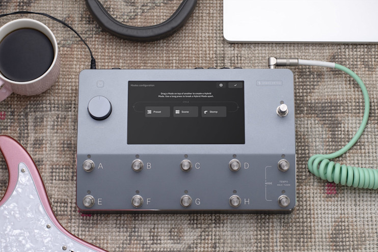

You can configure a Hybrid Mode via the new “Modes configuration” option on the Main Menu.
On the Modes configuration screen, you can re-order modes as well as create a Hybrid Mode.
Re-ordering Modes allows you to change their order when cycling through Modes on The Grid.
You can also drag a Mode to the top-right corner to remove it from the cycle completely. When a Mode has been removed, you can add it again by pressing the add button. It is not possible to remove all three Modes.
When you re-order Modes, MIDI CC values will not adapt to these changes. For example, by default Preset Mode is in Mode Slot 1 and is recalled via CC#47 value 0. If Stomp Mode is moved to Mode Slot 1, then the same CC#47 value 0 will now recall Stomp Mode.
Drag a Mode on top of another to create a Hybrid Mode. Once a Hybrid Mode is created, the screen will display the footswitch configuration. You can tap the Hybrid Mode block to flip the configuration.
It is possible to re-order the Modes or remove Modes even when a Hybrid Mode has been configured.
